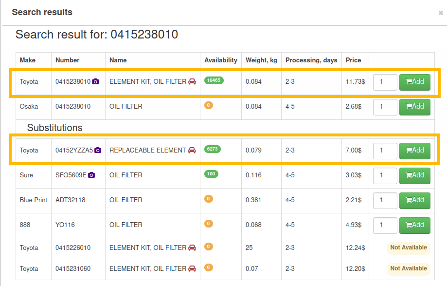

I searched for the oil filter on partsouq.
The part number displayed is:
0415238010 ELEMENT KIT, OIL FILTER
And under Substitutions an other Toyota part:
04152YZZA5 REPLACEABLE ELEMENT
What is the difference? Both original from Toyota, but one is $4.73 cheaper.

Got an answer from partsouq:
Please be informed that genuine substitution was removed.
The correct filter for your vehicle is 0415238010
so i ordered this one.
