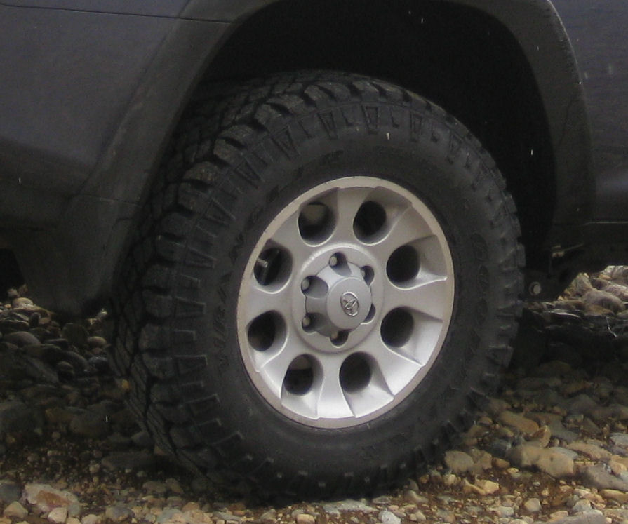

Duratracs rather than SilentArmors would be my suggestion. They aren't noisy below 45mph and I was thrilled with the real world performance in a snow storm. People have complained about them in the c-rated version but I think they all failed to inflate them to the proper 44psi. I've never experienced anything negative with them whatsoever over the last 21k miles.
