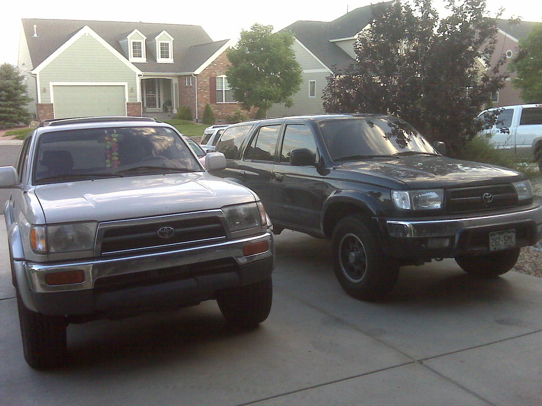

Anyhow...I'm gonna try to post a picture of Dark Runner(pre-bumper) and Fone Runner(what I now call my truck since I'm the phone man)...
