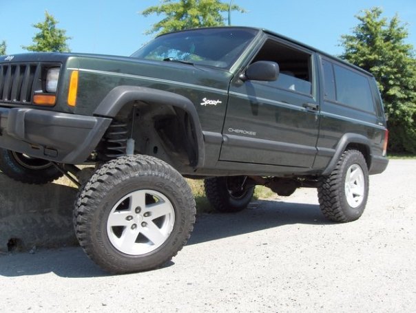

3.5" lift on my old XJ. The front end was pretty flexy compared to the IFS in the 3rd Gens. You can lift uni-body vehicles and off-road very well with them. Granted a Jeep is a far cry from a CX-3.
