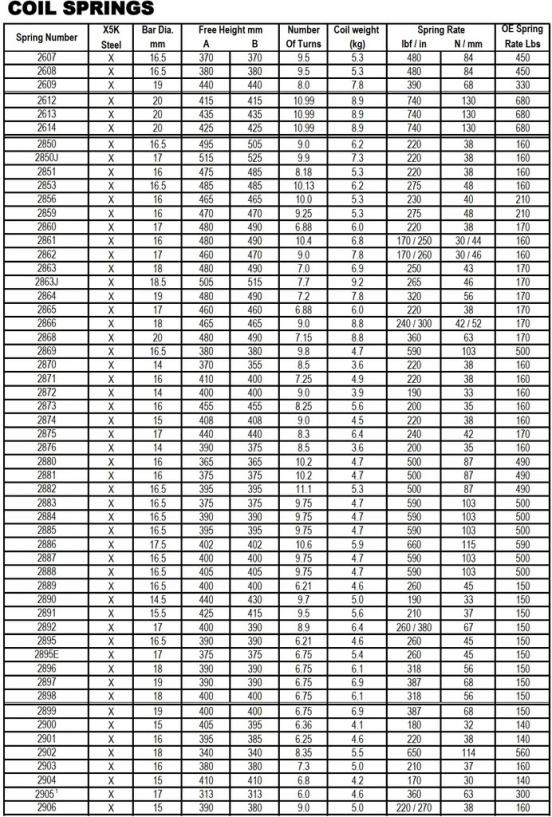

It's pretty difficult to find any specifics on these coils, however I found a chart on the OPTOffroad site that I copied here. There's two versions of the 895 listed that seem to be similar with the E version being shorter with thicker wire although providing the same lift and spring rate so it likely provides a stiffer ride. That being said the 889 and 895 really aren't much different from a spec perspective.
OME in my reading has always been known for providing a rough ride almost regardless of the vehicle. Based on that I've never used them. I've had really good luck with Dobinson's coils FWIW.
Here's the info I found from the OPTOffroad site: (Forgive the image size/quality it was hard to manipulate)
