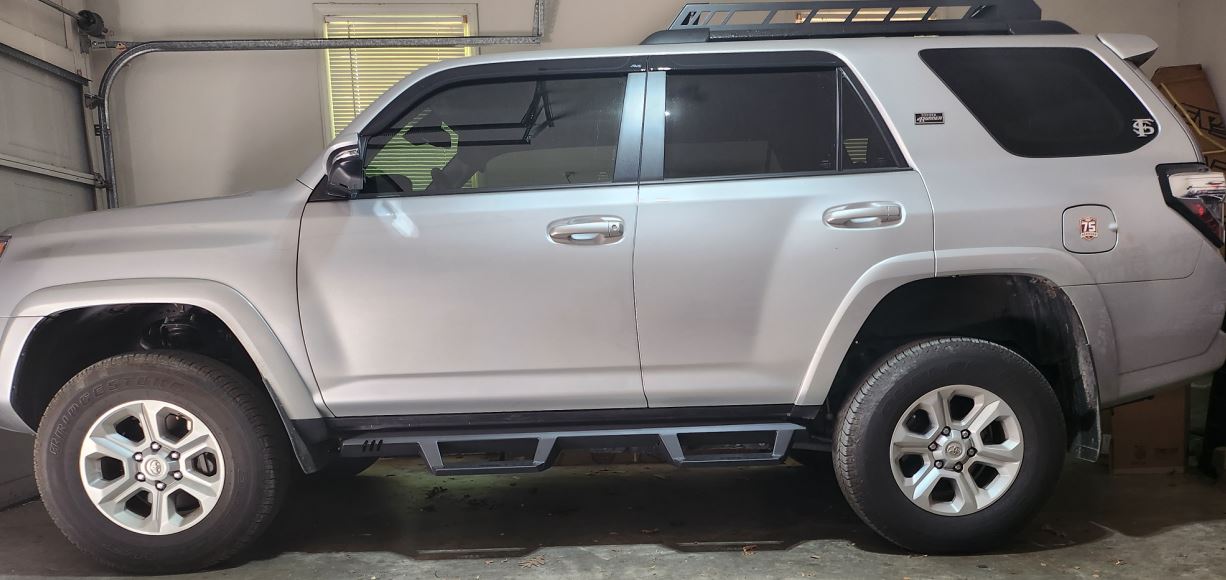

2.5" ARB variation installed earlier this year with ome wheels/tires still attached

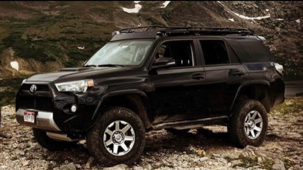

OME 885/898 on 255/80 17. Added bumper and winch after this pic and may get the next step up to better manage weight.
Is that the 255/80/17's on your truck in the pic?
Also what was the amount of lift that you got with the 885/898 springs.
Thanks Alumni...Jim
Thanks Alumni...Jim
Yes, 255 80 17 Falken Wildpeaks, lift is still about 2.5” in front, 3” in back, which is spec for springs. With the 33” tires, approach angle is better and nice to have the clearance below. Have added front Hefty bumper and winch since lift, previously had full alum skids, sliders and Gobi rack. I could go up from the 885 on the front since I added the extra weight up front, but it’s fine for now. I slightly regret not getting the higher weight springs from the start.
