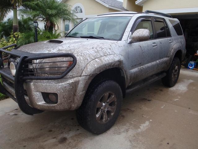

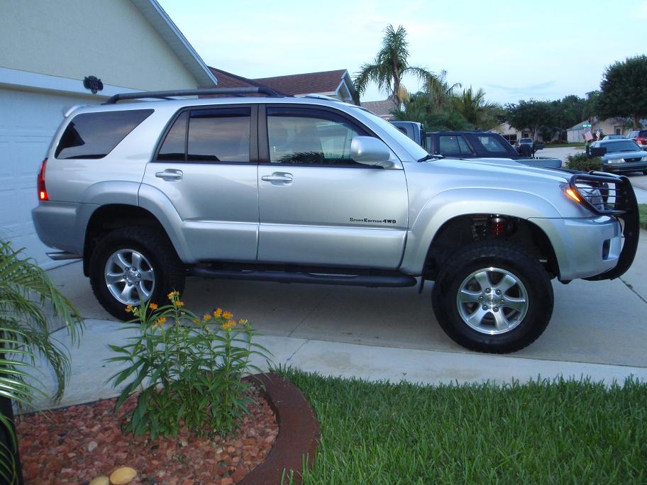

I also have the toytec ultimate. I had to lower the front some but with my 265/70R17 Nitto Terra Grapplers it looks and rides great.
Clean and dirty pictures of the my truck. I also installed my lift all by my self and was able to complete the install before dinner. Also here is a link of my install thread. It has pre and post numbers.
http://www.toyota-4runner.org/showthread.php?t=51730

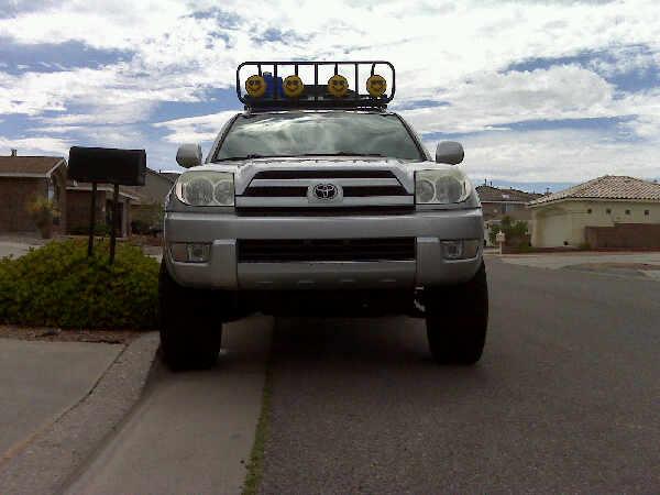

I had the OME lift on my FJ and the Toytec Ultimate on my 4runner and the ride difference is huge!! My 4runner rides like a dream! Not to mention that it soaks up harsh bumps like a knife through butter! I highly recommend the Toytec ultimate if you have the funds, but if the OME is all you can get its not bad either. Good luck! PS...here's a pic of mine with the ultimate kit....
