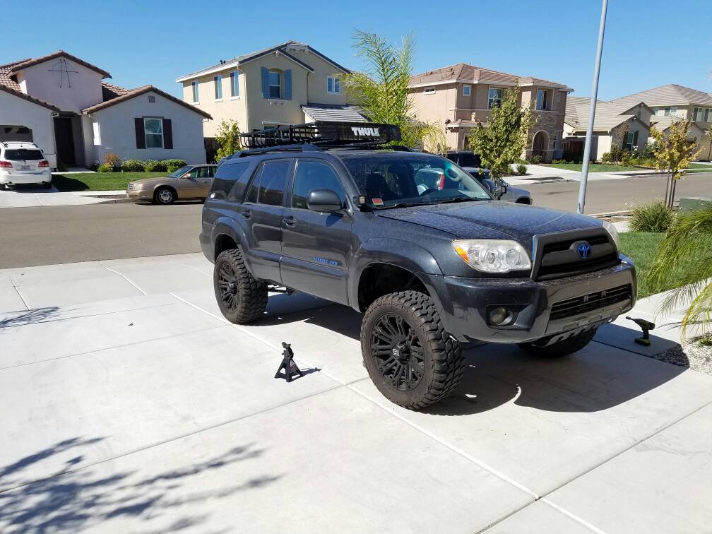

Got the clip setting lowered and reinstalled and it feels like a Limo compared to how it was before 20160924_111352.jpg
