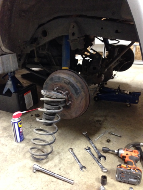

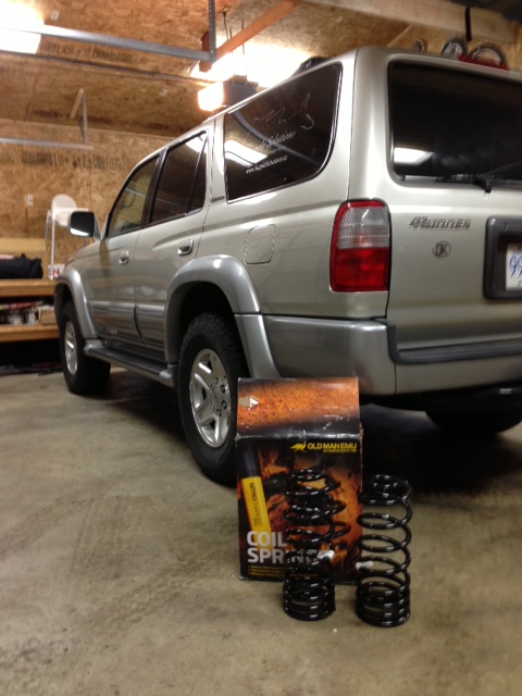

Update-906's are in. First impressions
Well I finally had some time to swap out my rear 99 talls and pop in the OME 906's (Bilstein HD's went in a couple months ago). Thanks guys for the notes and encouragement! Thanks Toytec for the great service and no-hassle transaction using my Canadian credit card with a US shipping address (this can be an issue with some places).

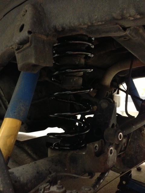

It took me about an hour and a half to complete but I really took my time and if I had to do it again it would easily be cut in half.

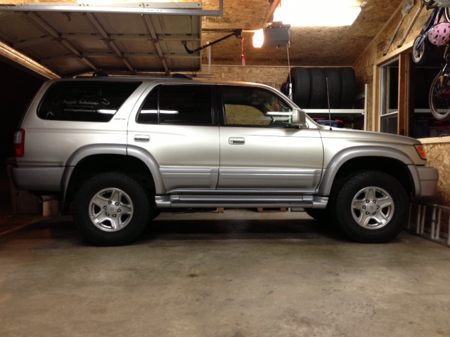

The rear lift was minimal (about 1 1/4"). This will vary depending on how your original springs sit. My rears went from 35 1/2" to 36 3/4" (measured from ground to fender flare). There is a very slight rake- not very noticeable unless you are looking for it (my wife didn't notice a difference in appearance)! The ride... is WAY BETTER! There is no harshness, it just feels more firm (in a good way). There is much less body roll which makes the truck feel more planted. My wife said that the steering felt easier! This would be the result of less movement/body roll from the rear. FYI, the only 4x4/off-roading this truck sees is gravel and snow packed roads so I can't coment on that. For me- these springs are for towing a ski boat or trailer and hauling the family and all our gear up to our cottage 4 1/2 hours away. I think they are going to fit the bill perfectly :)

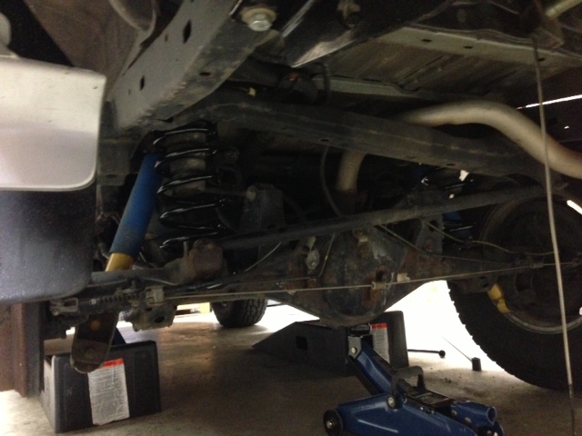

Here are a few pics I took along the way. The last one is when I took it for a test drive- it was foggy out and I thought the photo was kinda :cool:

Looks perfect
Looks perfect
Thanks, I like how it sits as well
Wait a second - what the heck are you jack stands sitting on ?
Lol... They weren't tall enough so I put them on Rhino Ramps! I know it looks sketchy... but it worked!
How you had the 4runner supported is beyond sketchy. Next time buy some 6 ton jack stands before engaging in that kind of work (not to sound like anyone's mom here).
