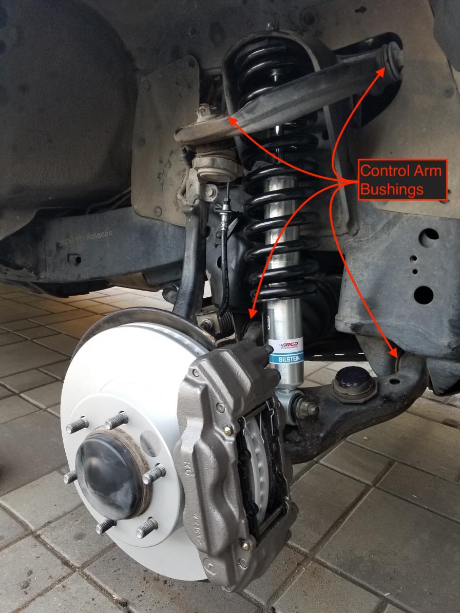

I did replace the LBJs, but not the upper/lower bushings. I'll keep that in mind.

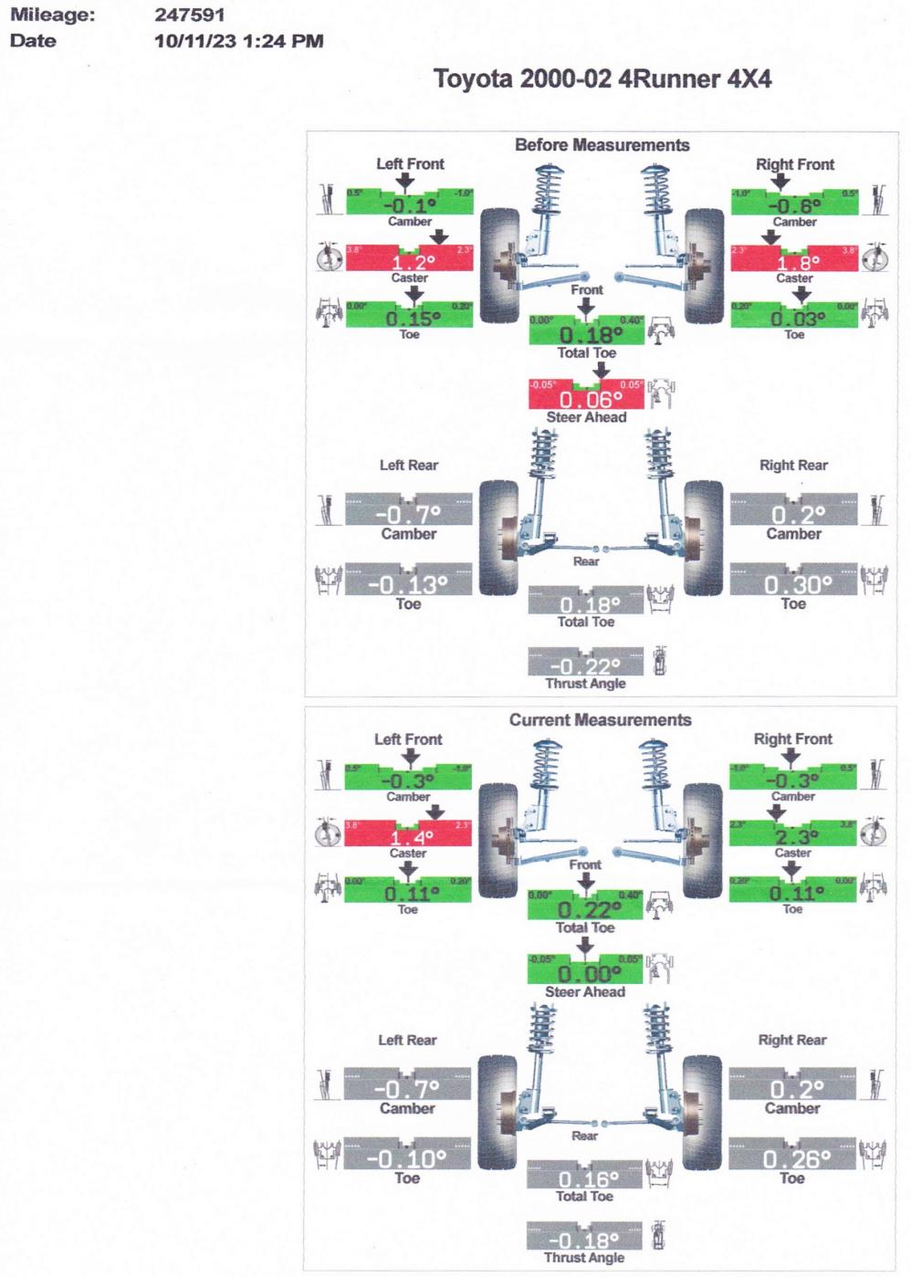

Did the shop give you a printout of alignment specs? If they did, post it for interpretation... even a shop that does things by hand (old school!) should still have a notes sheet that will give you clues.
That said, pulling differently during braking events is a fairly clear sign of a bushing issue.
-Charlie
Here are the results from the most recent (3rd) alignment. I did notice, from checking the series of previous "current" to "before", that they may differ by fractional degrees. I assume that's within tolerance of driving-off and setting-up.
Just so I'm clear on which bushings you mention... those in the pic?

Depending on your front height (2" lift or more...), the stock front alignment runs out of adjustment range. Assuming the tech knows what they are doing, that's likely what happened.
~1* of cross-caster will cause pulling issues even with correct toe, which you are experiencing. Such low average caster will also likely make it feel pretty poor at speed and lose some self-centering.
Check those lower a-arm bushings for looseness and get new upper arms with corrected geometry. You really want 3-4* of caster up front (matching within a few tenths side to side) and near 0 camber, also matched side to side.
-Charlie
