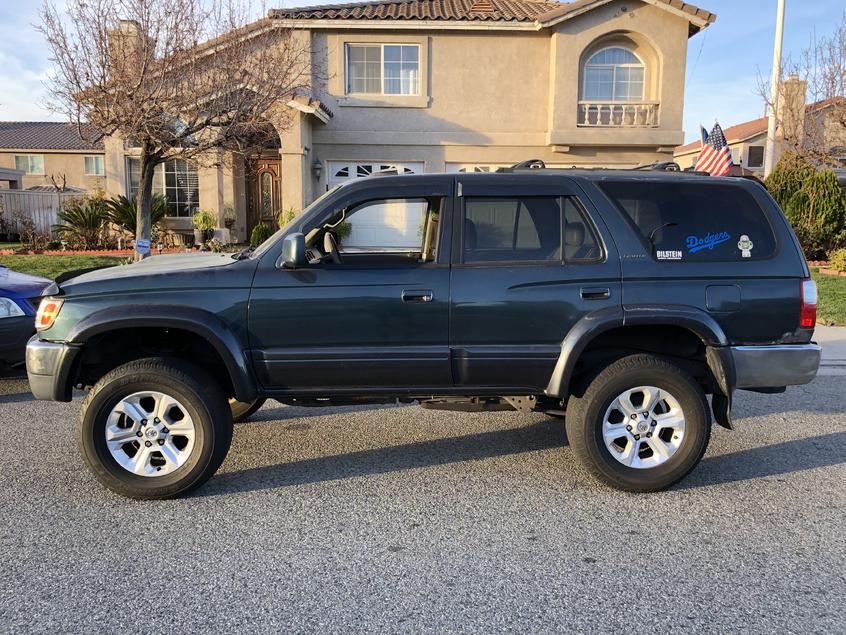

Just like everyone said, lowest setting. I just did the exact lift this ost weekend. It’s even all around 24” from hub to fender
