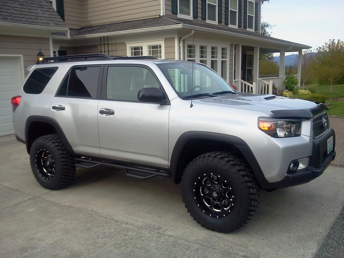

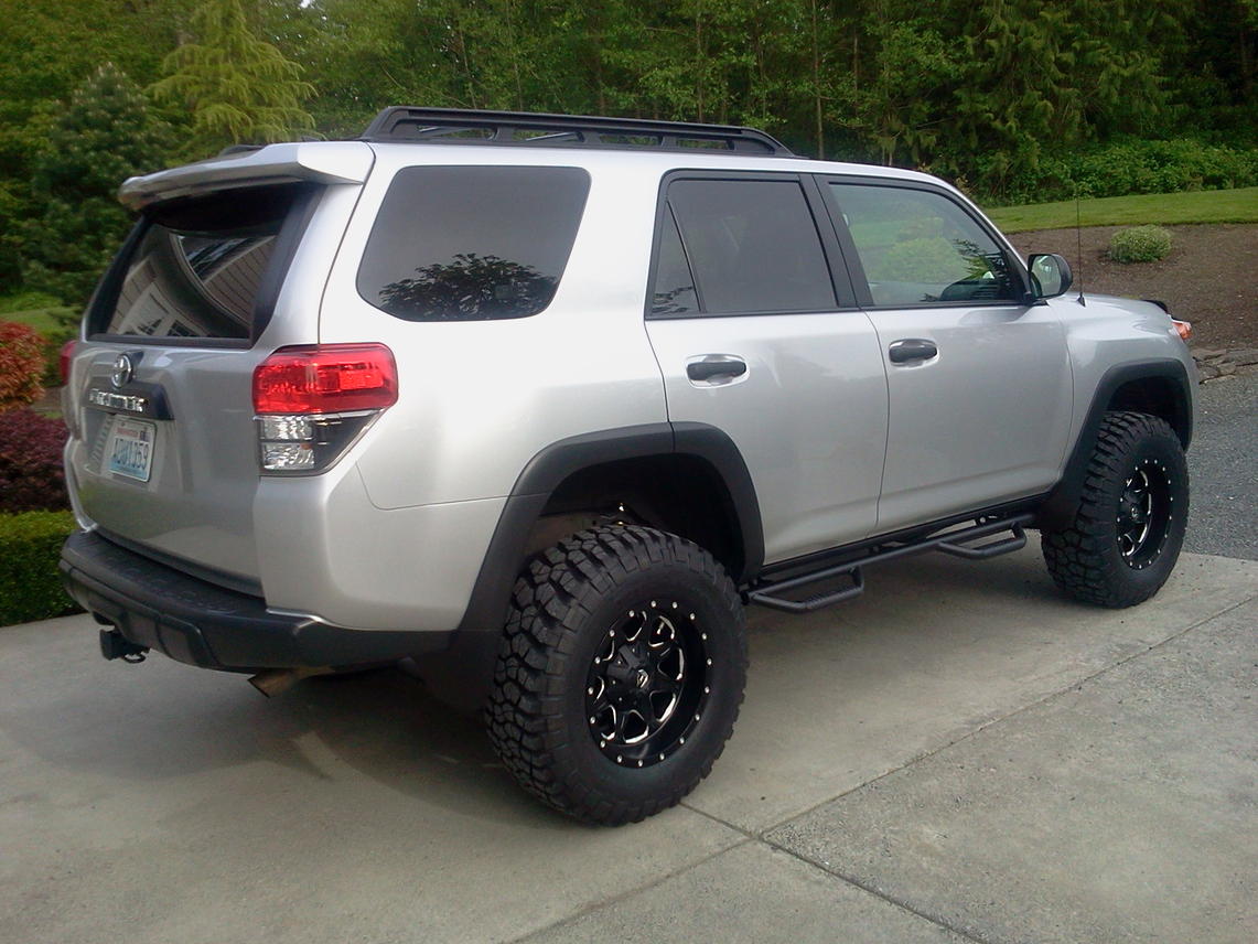

Going to a medium Rate rear spring to allow the rear end to settle down a little lower to help level it out. Installing my gobi roof rack next week. The stiff rear spring is for a consistant 450lb constant rear load. Medium is 225 lb load. The rake is 2" higher in the rear in tHis picture, I dont like the raked out look so hopefully the medium rear with stiff front will not be as raked out. I deffinately reccommend the stiff front, No front end dive at all when you Hammer the brakes, the suspension is great on road and I will be testing off road soon.
[/B]
That helps, thanks. I'm going in Monday to get stiff OME on both front and back, maybe they will have a medium laying around that I can throw on the back.
