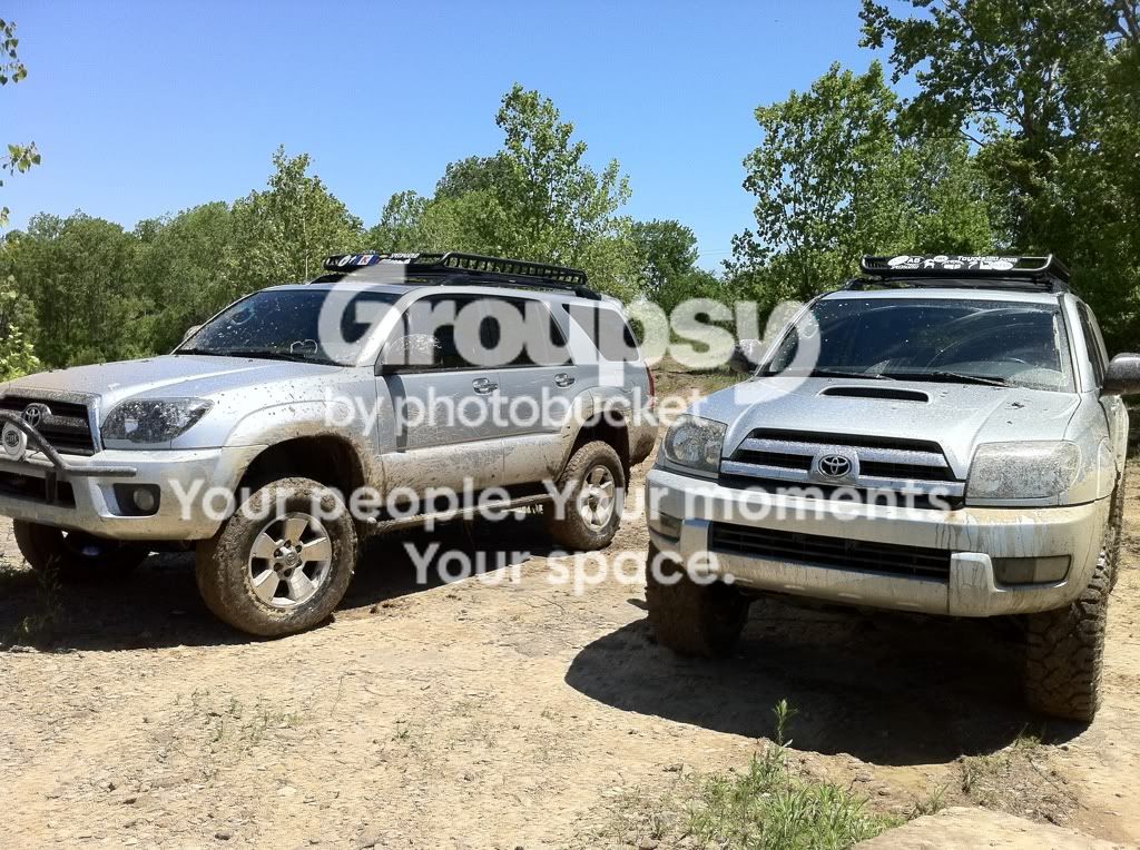

I am installing an OME Heavy lift with ARB bumper. Considering FJ 17inch wheels. I understand the offset is 3/4 inch difference from stock. If I run 285/70/17's Goodyear Duratracs will i need spacers?
I say no. Im running the FJs with 285 duratracs and think they sit perfect. Ive got right around 4" (maybe a bit less) of lift between the FJ suspension, 2.5/1.5, and 1" body lift.
Mine is on the right. To give you an idea. Its not the best pic, but they are right at the edge of the fender.
