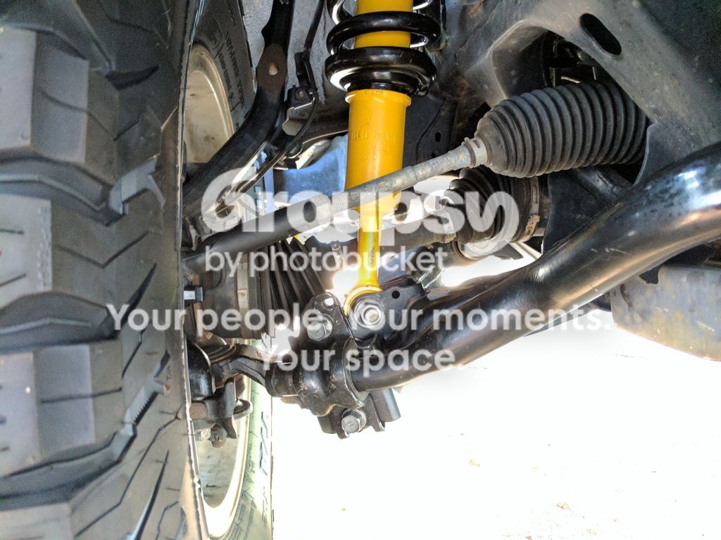

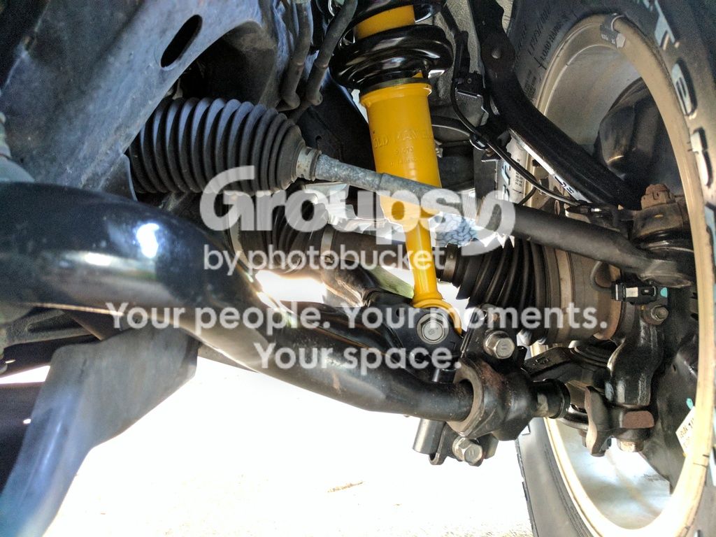

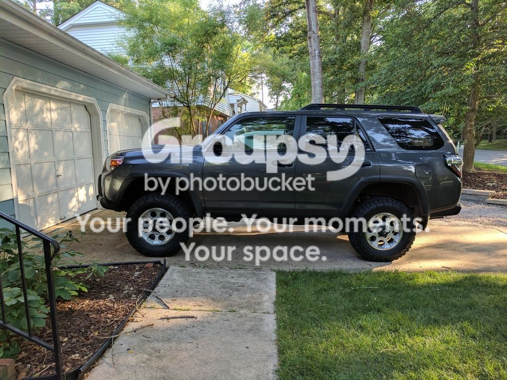

Finished installing the OME lift with 884 lights in front and 889 coils in rear.
I'm concerned regarding this having possibly created "too much" of a lift in the front. Can I get some opinions on if things look "correct", specifically regarding the CV angles.

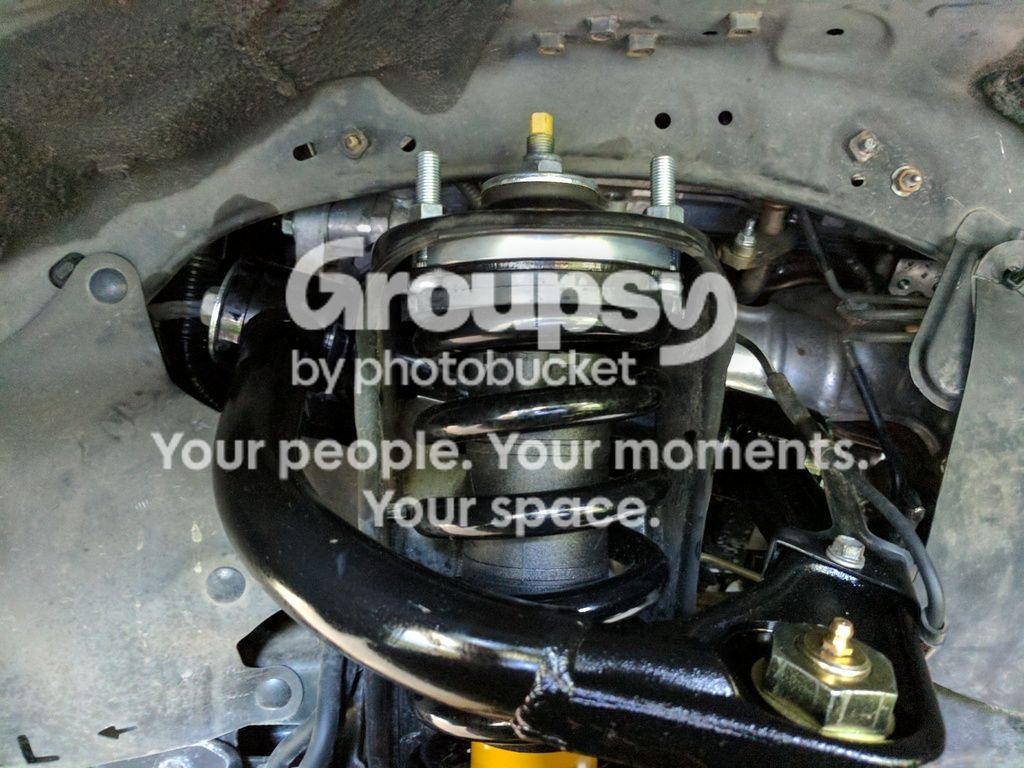

I did install the provided spacer from Toytec which i believe may be adding to the over concern.
Additionally LR UCA was installed and alignment has been completed as well.
Running with 275/70/17 BF KO2s.
Let me know what you guys think, and enjoy the pics!

Looks good. Did you install the Differential spacer that Toytec sells & the sway bar relocation kit? The diff spacer will correct you cv angles.
I did receive the front diff drop, however everything I read stated there was no real benefit. I didn't ask for it in my order though.
Could still use if there is some positive gains to be had though...
Looks good, the CVs look a tad too close (ie lifted high) for my comfort though if you are doing hardcore stuff. I'd take the spacer out if it were me.

So they included a top hat spacer? I wonder why. seems odd since the ome stuff is designed to be vehicle specific typically and no need for spacers. How thick is that spacer?

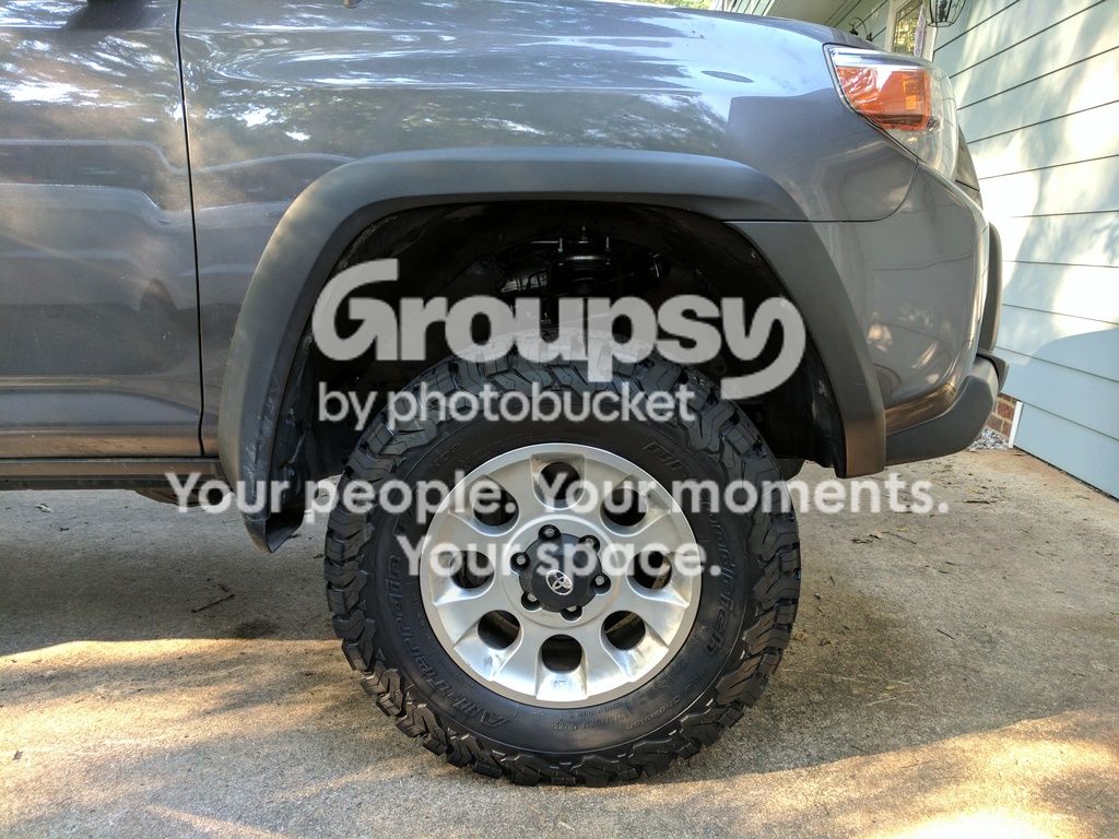

Take a measurement from the center of your hub to bottom of fender flare.

The spacer included appears to be 1/2 inch. From what I've found this is to provide 3 inch all-around as the OME alone provides 2.5 up front and 3 in the rear.
Measured center hub to bottom fender flare and it is 24 inches all around.

You are running about 4" of lift then up front... 20" seems to be about the stock height. I've ran 23.75 for a long time with no issues, but I feel like that is near the limit to keep CV boots happy.
also, you probably have a reverse rake. The rear should be about 1" higher with that measurement.... Stock it is about 2" higher.
If the spacer is 1/2" it will yield 1" of lift due to the motion ratio.
I ran my OEM lift with no spacer and it was about 3" of lift. Maybe what you have is different, but seems odd to add anything more than a thin 1/4" spacer.
Thanks for the input. Looks like I may need to pull the spacer.

Looked at my packaging slip from toytec and it does appear I was given the following:
Front Top Plate Spacer Kit
Since it came "assembled" I didn't think twice about if it belonged there. Going to look into removing this as lift and spacer is more than I was looking for.
Think it would be ok to reuse the longer studs provided and simply remove the spacer?
