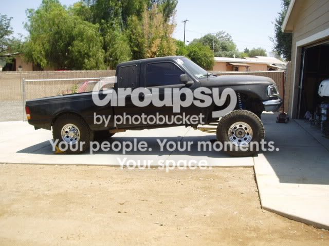

Exaggerated picture of bro rake/cali rake, won't be quite this bad
