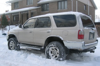

Let us know which suspensions lift you will install. Measure with stocked tires (tire size) from fenders to ground. The only way to find out how many inches you lift your rig. Take pictures before and after you installed the lift.
4X4snowRunner
front:
OME882
OMEn91s
5mm trim spacer
tapered 1" diff. drop
rear:
OME891
OMEn86
5mm trim spacer
adjustable trac/panhard bar

I installed OME882 with long strut OMEn91s gives me 3 1/2" lift on the front. After driving for 1000km. the suspension settled to 3 1/4". Anyway when I installed the suspension lift it give me full droop result of the inner cv boot to leak grease. I did more research how to fix these problems. I already order diff. drop and see if that help. If not I'll go with Camburg Uni-Ball Upper Control Arm Set.
http://www.wheelersoffroad.com/camburgco4run.htm
4X4snowRunner
front:
OME882
OMEn91s
5mm trim spacer
sonoransteel tapered 1" diff. drop (installed with original skid plate, work great)
rear:
OME891
OMEn86
5mm trim spacer
sonoransteel adjustable trac/panhard bar (installed)
265/75/16 Geolandar i/T
