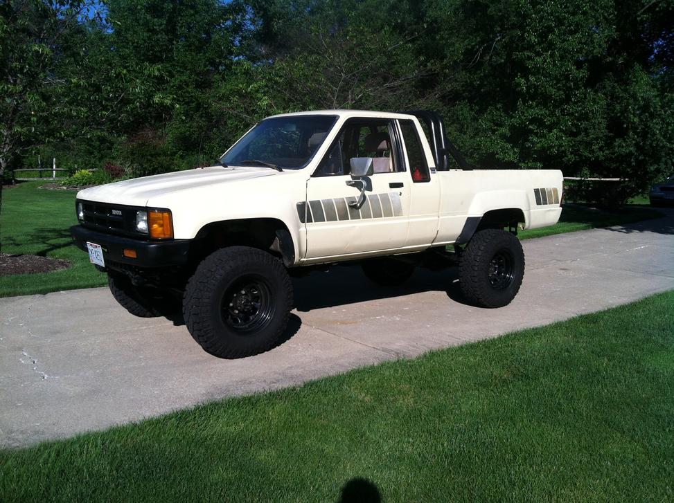

I have OME light duty springs (and shocks) all the way around on my 85 extra cab. $350 for basically brand new is a good deal. I used stock shackles and didnt change the pitman arm. I did end up taking a leaf out of the rear because it was much higher than the front. As for shims, you might be okay on a 4Runner. the truck has a slight vibration in a small range of speeds, but when there is a little bit of weight in the back (my dirtbike) any shaking that i had goes away. Also, fully flexed, there is still some slack in the brake lines.

here is a pic for reference. I am running 31's and could easily go to 33's.
Hope this helps.
