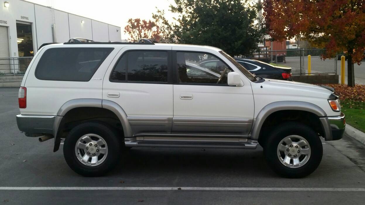

Pics or the rake?
TRD on lowest perch in front, OME 906 and 10mm trim pack out back.
