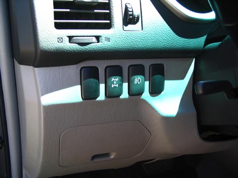

The fog switch that goes in the blank on the dash over by the center diff lock switch, AC 110v outlet switch and airbag cut-off switch comes from the 2005+ Tacoma's. IMO, it's the best way to go for a stock and clean install. The switch if I recall is $60-70.
Thanks you so much , that clears it up for me.
I'm going to order a switch from partznet , maybe even get an extra on e for some aftermarket off road lights too while I'm at it.
looks good for sure!
