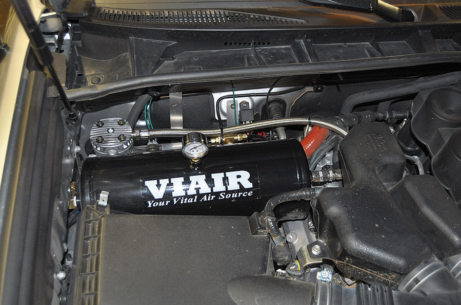

ViAir 480c with a 2 gallon tank. I bought my tank,lines 120/150 pressure switch and valves from hornblasters.com . Basically picked their brains for what I needed and how to hook it up.
And a recent pic after wiring and plumbing.

ViAir 480c with a 3 gallon tank. I bought my tank,lines 120/150 pressure switch and valves from hornblasters.com . Basically picked their brains for what I needed and how to hook it up.

Very nice install Harper. How difficult was it to mount?
