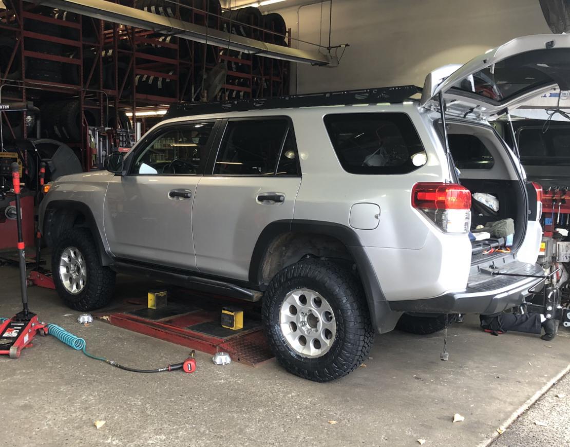

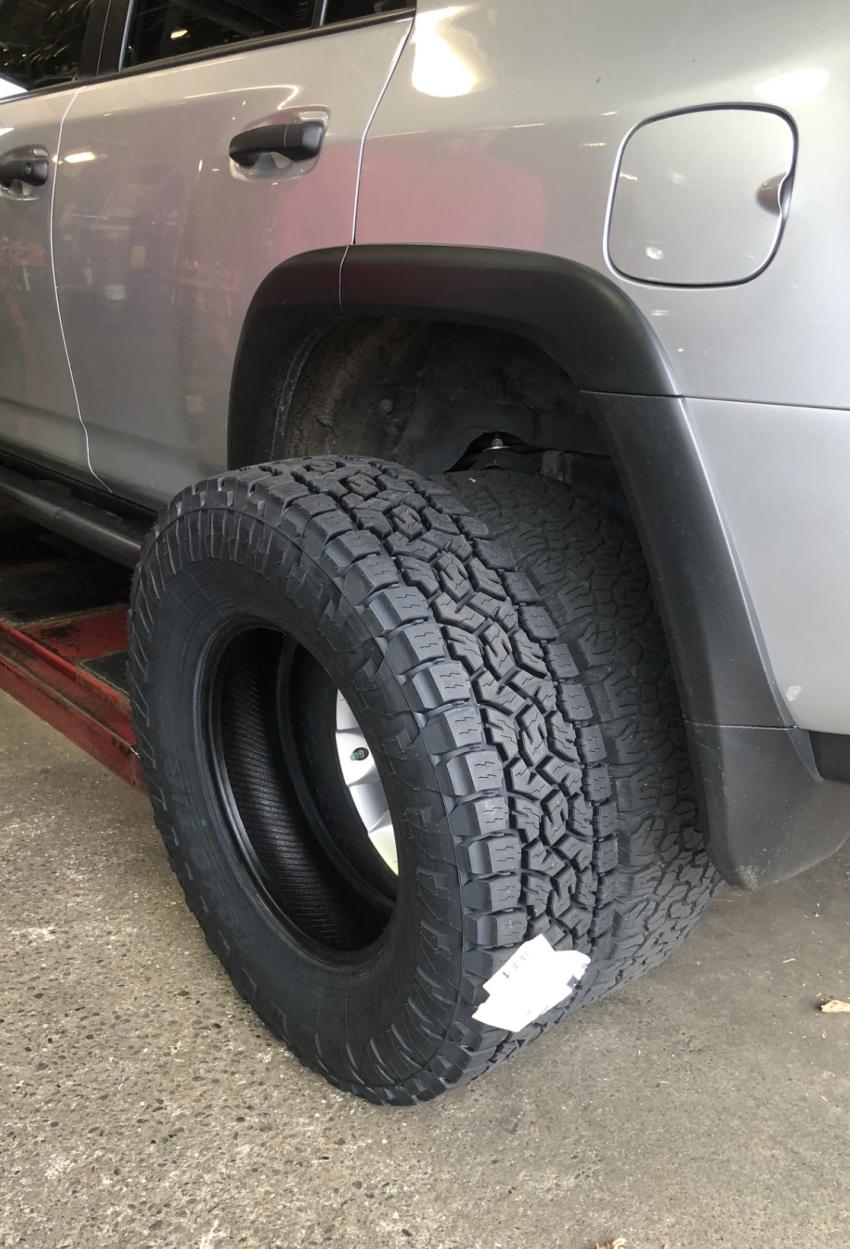

Taller than I expected. Hope they fit…

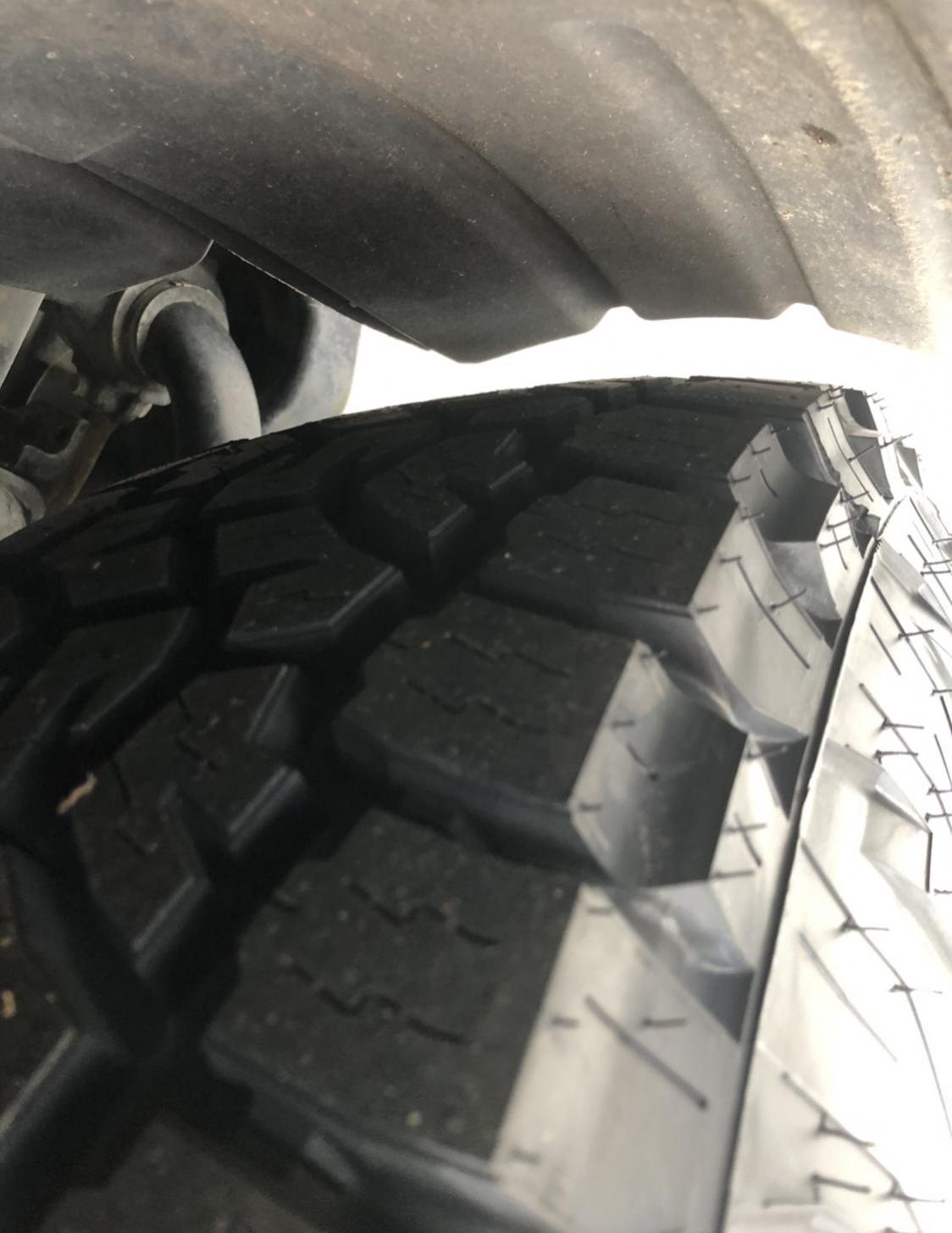

They fit with no rubbing on the body mount or front fender liner.
The spare is another issue. I was able to shoehorn it in there but with my hitch installed I could only manage ~1/4” clearance with the Swaybar and KDSS cylinder. I guess that means it fits but we’ll see if it rubs anything under articulation.

A quick update- it’s only been 2 days but my first impressions are very positive. I’ve driven some freeway and around town miles in rainy wet weather for the past two days. The tires have not slipped yet and have tracked very well in both environments. There hasn’t been enough standing water to comment on hydroplaning at this point. I’ve also had them on a bit of gravel and they hold/throw way fewer rocks than my KO2s did. Braking does feel a bit more labored but I’m not certain yet if that’s the tires or if I’m looking for a negative.
Also, I was worried they’d look funny as this is my first set of tall skinny’s but I think they look great. They fill up the wheel well nicely, add sidewall, and fit the factory rims without contacting the UCAs. A win win.
Take a look at close to full steering wheel lock and suspension compression.
The close-up photo above is at/near full lock. There’s quite a bit of clearance at that point while on flat ground. I’ve tried to flex out the suspension a bit but have not yet been able to fully compress my front end while turning. I’ve turned at full lock in both directions while driving forward and in reverse over uneven ground and have not yet found any rubbing.
Do you have personal experience with these tires and rubbing? What was your experience?
Thanks for the pics, I’m looking at 255/80’s to replace my Duratracs.
Would you say that the truck sits noticeably higher than the 265’s? Any estimation on how much added height these tires provided?
265/70R17 = 31.6”
255/80R17 = 33.06”
33.06 - 31.6 = 1.46”
1.46”/2 = 0.73” taller
Some variance between tire makers so it may be a little more or less than ~3/4 inch.
