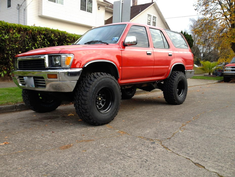

Hey hey... so I have been debating whether to install my built 347 motor and c4 transmission into my 92 4runner. Both have been custom built with all new parts for my 67 mustang. I lost interest in the mustang restomod build and I know I wont get what I paid for it if I sell it unfinished. This is not my daily driver just another toy. Motor and transmission are just sitting in my garage. Plus I hate the 3.slow motor!
I need motivation and advice from yall to whether to do it or don't bother with it. For the ones that will argue why put a ford into a toyota... I say why not, if it aids in my pursuit of wheeling happiness lol
I will take any advice... issues, fitment, guidance
here is a pic of my truck... don't hate on the massive amount of bling from the front bumpers... lol :pound:

I can side with you on adding more under the hood and getting the 3.bolw out.
I've never been a ford fan myself, but to each his own.
I will say that it will be a very tight fit.
Like mod the fire-wall and still cant fit a proper radiator in, tight.
(I'd go with a Small block chevy myself, but you know of how often people 5.0 swap a camaro.) LMAO!!!! :flamethrwoer2:

True true... I was thinking about the chevy motor but I have a brand new rebuilt ford motor and tranny sitting in my garage! I have no idea what to do with it now.. I really don't like fords anymore..
On another note I believe the ford motors are narrower and easier for fitment when compared to chevys. This is what i have been told.
there should be plenty of room.
and with correct accessory/pulley set up you may even be able to run an engine driven fan. at the least a puller E-fan.
Yes, keep it ford.

I say most definitely go for it! I already did the Chevy route, and it was great when done (although not so great at times when putting it together--LOL). A Ford V8 would actually fit better than the Chevy because it IS narrower, and the distributor is up front (a BIG plus!). You'll have a blast. Check out Advance Adapters for kits, as well as Northwest Offroad (who use many of AA's kits--they just won't tell you up front).
Thanks for all the support guys! Yea I agree mr bucknut with all the countless hours spent researching and reading threads most say the ford will be a bit easier to work with.

Just remember, when considering the BFH approach (big f'ing hammer)--on a 2nd Gen, the heater core is right behind the firewall, so you can't reshape it much at all without losing your interior heat.
I considered doing this before I ended up installing a new 3.slo.
I like that the dizzy would be in the front (no firewall hammer needed) but then I realized that a Ford 302/AOD/t-case setup will put the front drive shaft on the wrong side.
However, it is possible to run a gear drive Toyota t-case with some mods to the Ford tranny... I just never got that far.

unless they really changed the engine bay on that year, you wont have any problems with firewall clearance. there is plenty of room
altho, I DO have a stupid body lift on my 85, im POSITIVE it would still easily fit without it. I just haven't cared enough to take it off...
I was recently measuring to drop in a 4.6 DOHC to replace the 302. the heads on that thing are HUGE. im pretty sure it would fit, but I would have to move/rework the steering shaft.
