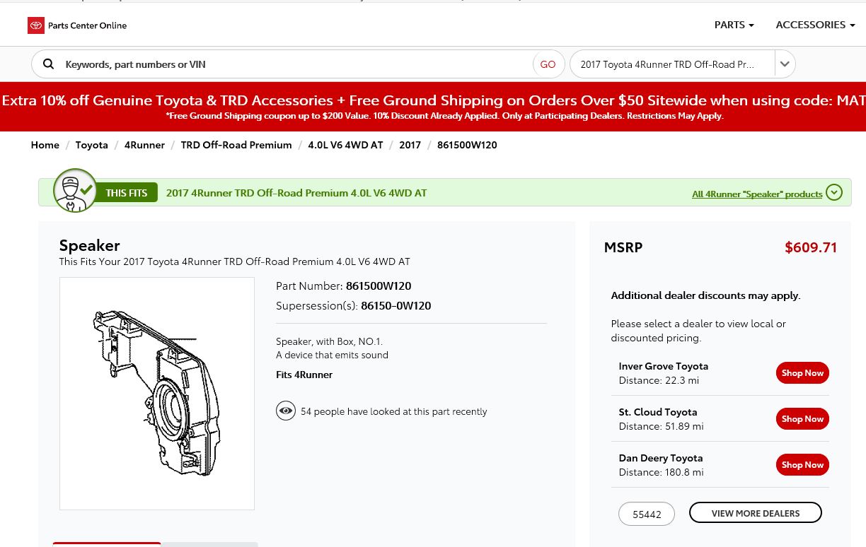

for the price I would go factory enclosure. for about $180 + $200 sub. Even running the stock JBL speaker was pretty good. With my $60 Skar 8" sound great. missing the low response like the jl 8w3, but for $60...
I would LOVE to know where I might find a JBL OEM enclosure for ~$200!! Please help! I have a buddy that was going to go this EXACT route and found the Alpine wouldn't fit under seat either. I cant find that plastic enclosure for him for anywhere near that even on ebay and such.

That's the speaker box with the speaker, you can order it without the speaker as well for cheaper

There is another part that I believe should fit as well. I don't know why it is cheaper:
86150-35080
It runs for $170
Anyone know why this wouldn't fit?
Ah, thanks. It's not so clear on the online Toyota parts dealers websites.
Next up, since I only 2 rows and I don't have a sub already, I'll likely need at least this other part:
Lower Quarter Trim - Toyota (64730-35140-C0) - $312
I don't know what the trim piece looks like though as the line drawings are all the same and no actual photo.
