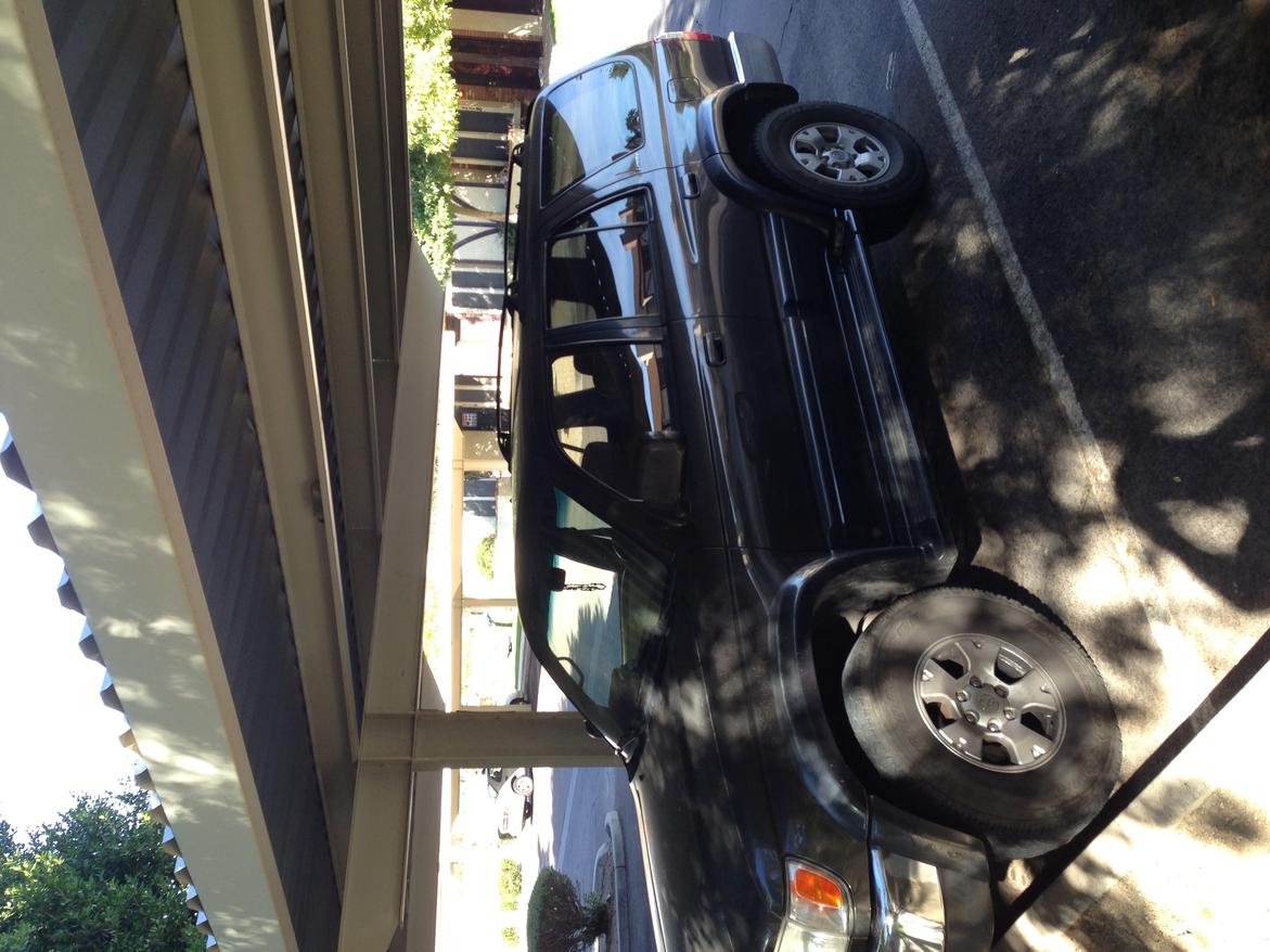

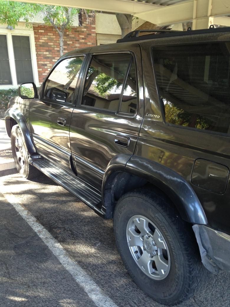

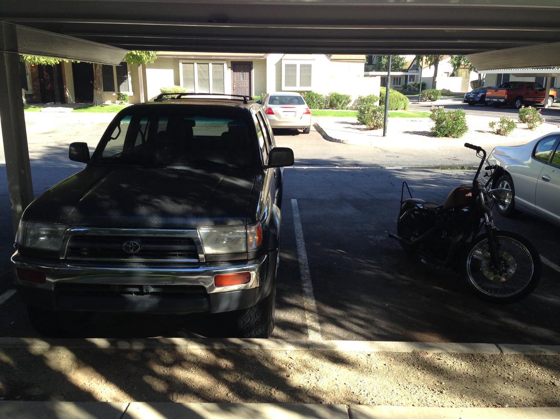

Sounds good! If I need to make a more stable panhard setup that's ok with me. I'll see if I can live with the adjustable. Here are some pics of how she sits for now. The Harley is sold to free up $4500 to dump straight into her. Lift, wheels/tires, paint, rack, LED lightbars and who the hell knows what else?! Haha

She's gonna be fun! I'm thinking of stock color (dark metallic silver/grey), powder coated bumpers (black), rhino line limited door/fender trim (black) maybe powder coat the wheels CAT tractor yellow, with the lift, rack, lightbar, etc. can ya see my vision? Then when she's all set and lookin really nice I'm gonna go make her really dirty! Hahaha
