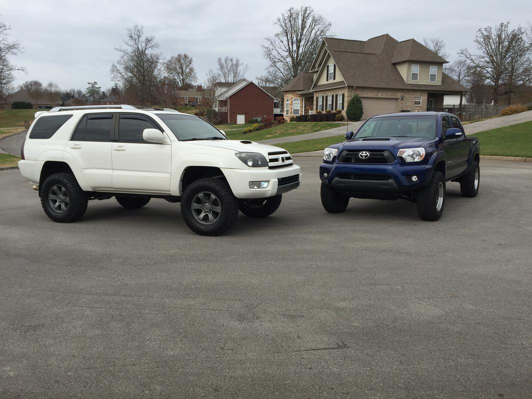

Plasti-dip your wheels, then spray paint over, if you don't like the first color, just spray over it with another color! Done this several times and I always end up with rustoleum hammered grey!
There is a dark bronze under the grey in this picture!

I don't quite get the idea behind painting over plastidip though. I will never go back to the current color in all it flakyness and I can paint over paint just the same without the plastidip beneath.
Well if it takes you 15 different paints to get the color you want, you don't want 14 different layers.
