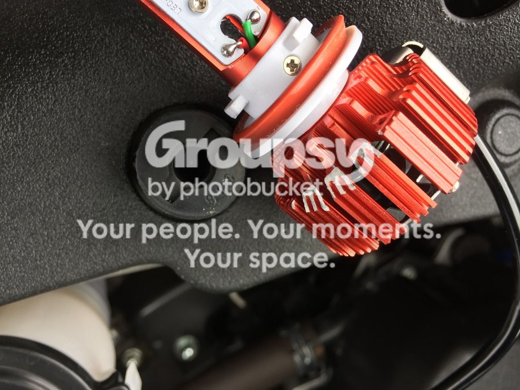

Originally, I ordered the phillips LED lights, but after reading a post from [MENTION=104049]marshal[/MENTION] and learning the lights are sub-par. I ordered a few sets of LED lights to try. In the end, only one set (OPT7) would fit in the 2014+ housings.
The reason the off brand does not fit the housing is because of how close the light hole is to the projector housing.
The off brand:
It has a square heat-sink that is too large to fit in the housing.

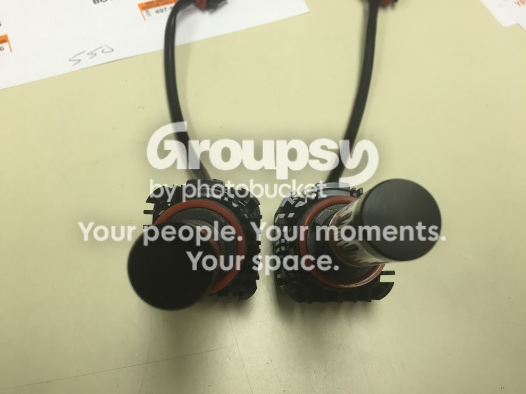

So on to the OPT7.
They also hit the housing, but a very little trimming allowed them to fit nicely. I had to trim three fins back about a 16th of an inch, it's so little shaving It hardly has to be done.

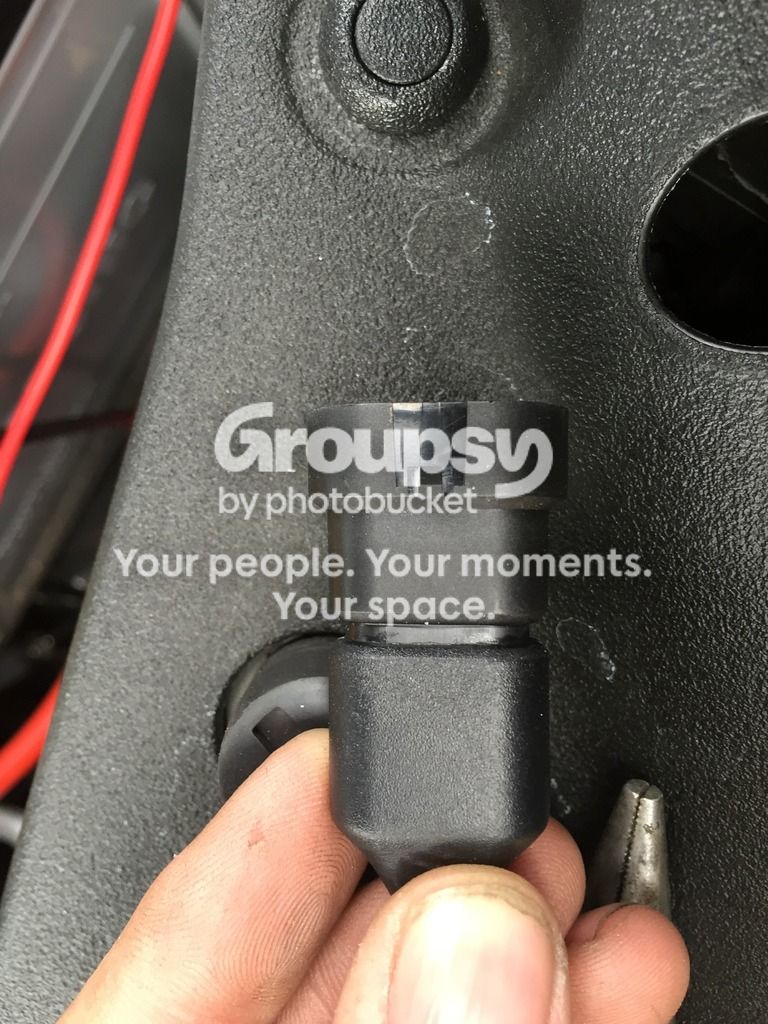

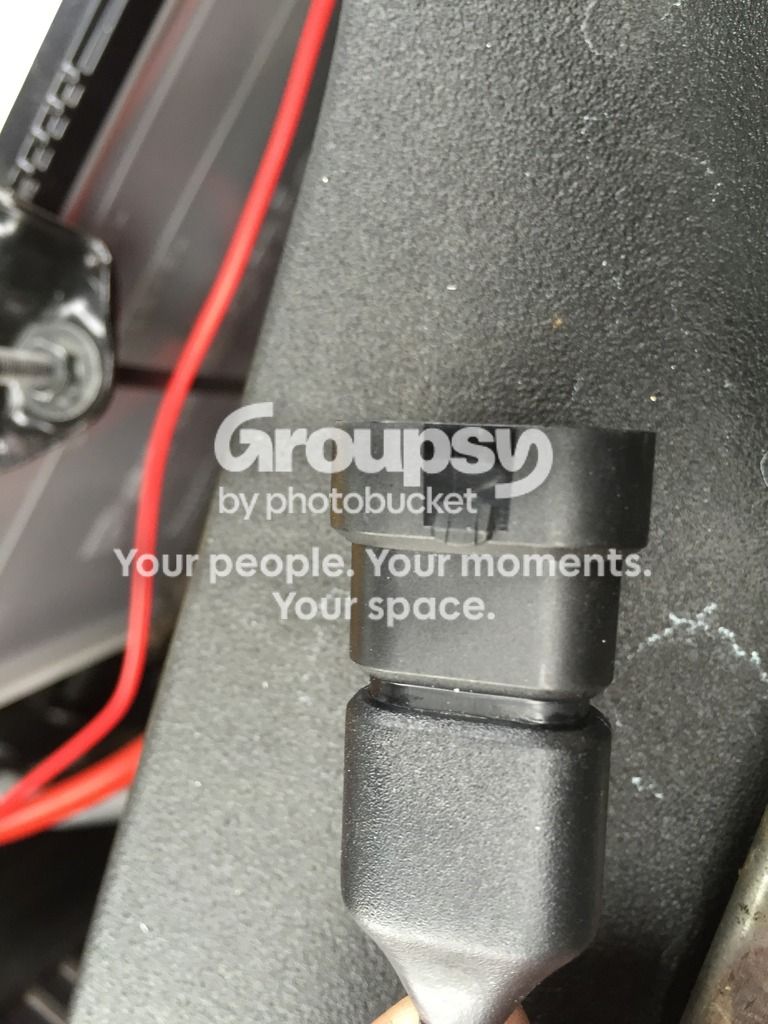

NOTE, you do not have to use the supplied polarity reversal pigtail. You do however have to trim the nub on the OPT7 plug as it is too wide to clip into the OEM harness.
Before:
After:

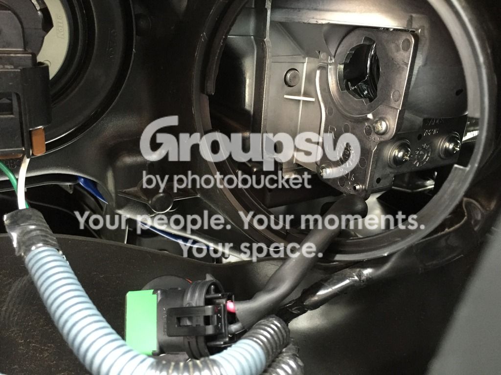

In the end the install was not that rough, just required a little problem solving.
