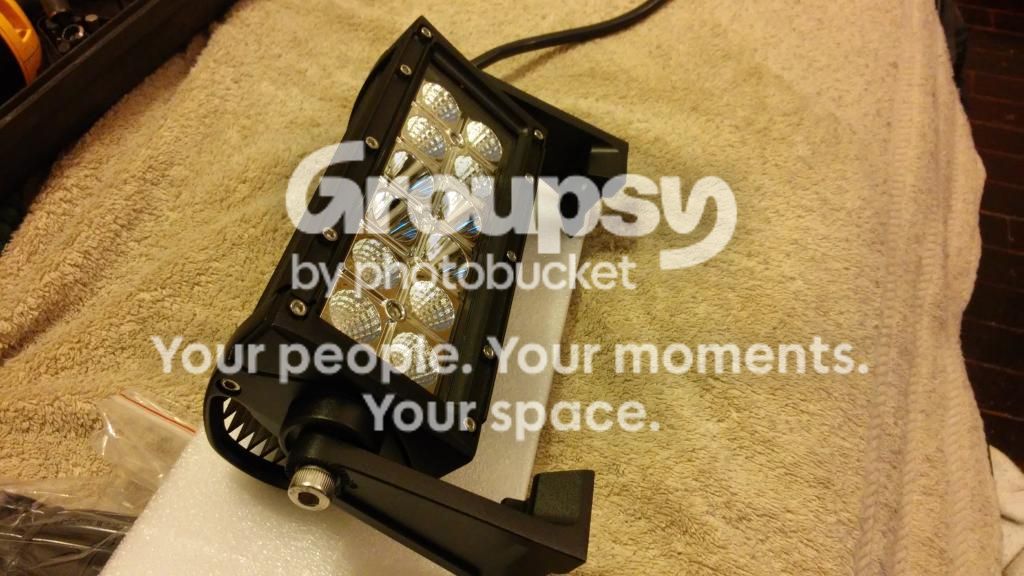

<a href="http://s1077.photobucket.com/user/rigtec/media/46ec6df0-94a3-41a8-84d6-aee9acac7535.jpg.html" target="_blank"><img src="http://i1077.photobucket.com/albums/w465/rigtec/46ec6df0-94a3-41a8-84d6-aee9acac7535.jpg" border="0" alt=" photo 46ec6df0-94a3-41a8-84d6-aee9acac7535.jpg"/></a>

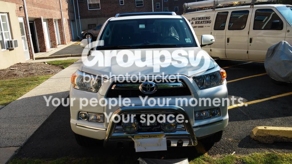

The other reason that I wanted a 'short' light bar in front of the grill, is because after I installed the fog-lights I realized that I had obscured the front license plate and where I live, they will ticket you for that! So I moved the license plate to below the grill to avoid getting pulled over. But after I moved the plate, I noticed that It left a gaping space between the two PIAA fogs, like a row of missing teeth (drove me crazy seeing that), so I wanted something to put there to fill that empty space. The short OPT7 light-bar seemed the perfect thing! The price was a very strong selling point for me; at $69.00 for the 8 inch LED device and just $89.00 bucks to include the complete relay/harness assm., you can't go wrong!

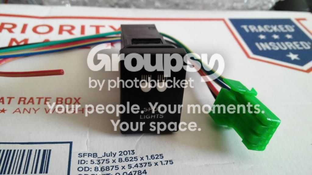

Oh I forgot to tell you... the reason that I couldn't use the 'G.B. Code' is because I got this switch from "Slee off-road". I really wanted to get "green" led indicators this time. The switches (AOB/Slee) are exactly the same (chassis wise), so I can just swap the faces out once the new switch gets here! "... So glad there was a good reason that I didn't use the discount"!
Switches are different, sorry to say rig. Face on AOB switch is molded where Slee has tabs/clips and face is removable. Face plates are also slightly different, AOB is slightly larger and binds/sticks when fully depressed. Circuit boards are slightly different, Slee's board is a tad longer, but you can shave down the front edge of board with a razor knife to make it fit. Basically the board has to move forward so that when you depress switch face it engages switch on/off.................ask me how I know...................

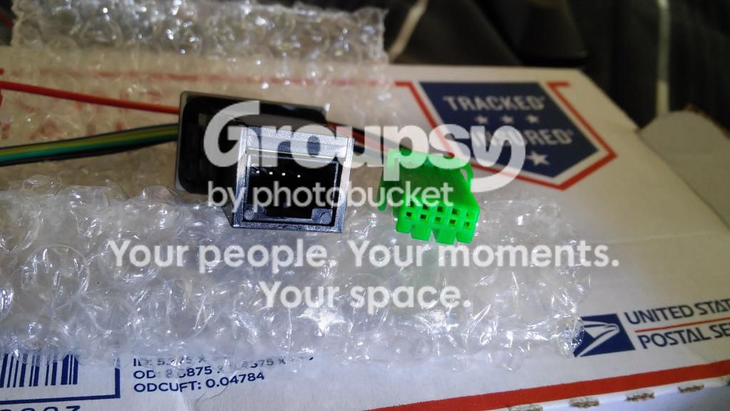

The new switch from "Slee Off-road" w/Green led illumination.

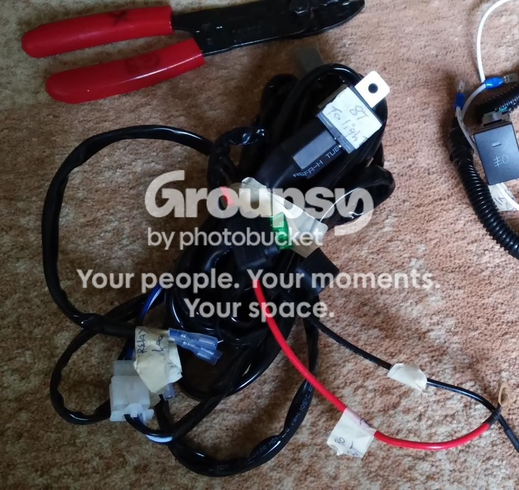

"Below is the "OPT7" C2 lighting harness that I ordered w/ the kit" ($20 bucks) "Masking tape was used to mark wire designations for later"
This wiring harness (above) is so well built! The relay is a 'standard' 12V spst sealed 30A unit. What I like about this is should the relay go bad, I can run into 'Auto-zone' on any day (even Sunday) and pick one up; no need to send it back to the company and wait for them to send another one back to me, it even came with a 30 amp 'In-line fuse' & holder!

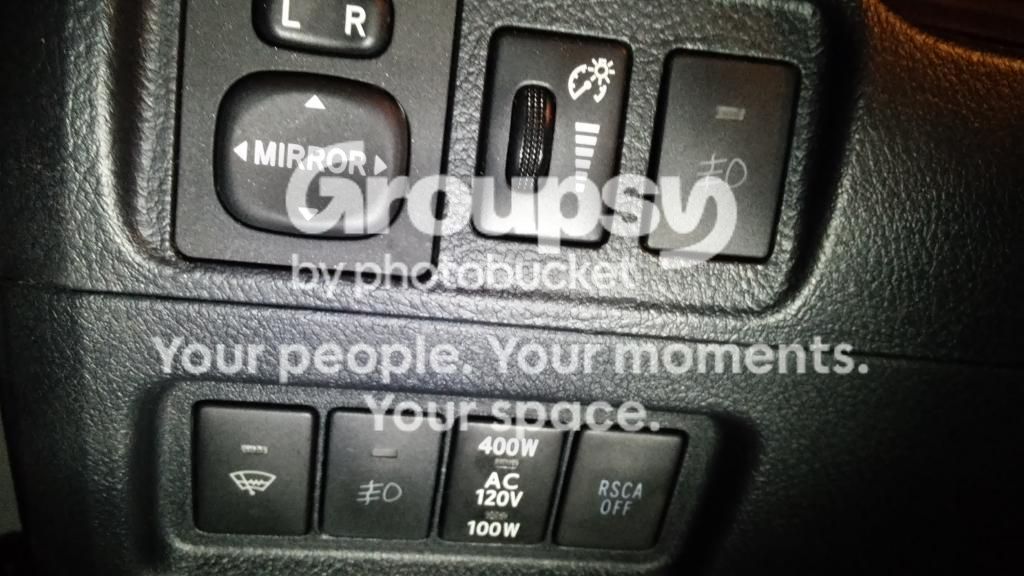

"It's the one between the 'windshield wiper heater' and the 400W inverter button" (lower row)

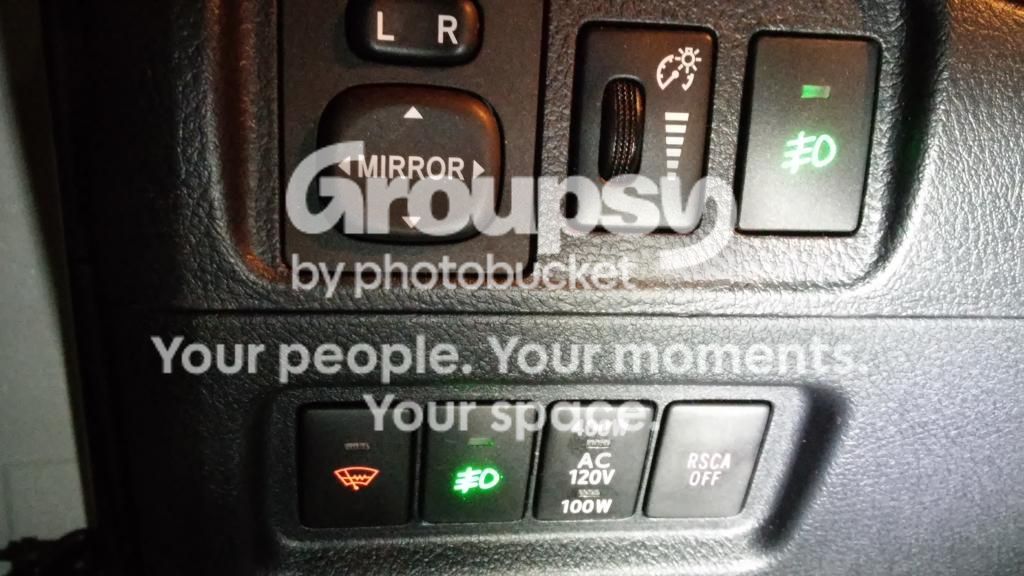

The other switch that looks just like it (upper row) is the PIAA fog lights. Here you'll see that I have the instrument cluster lighting circuit optimized to include both aftermarket switches, so they'll glow along with the others; Headlights and PIAA fog lights are on!

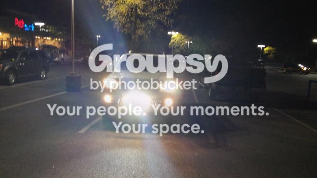

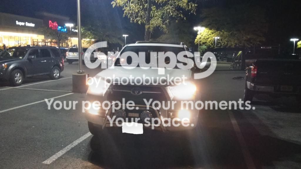

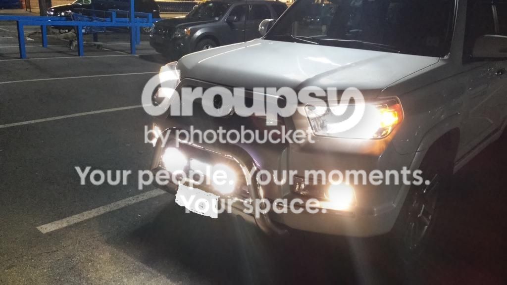

And below with "Headlights, Foglights and Light-bar" on!

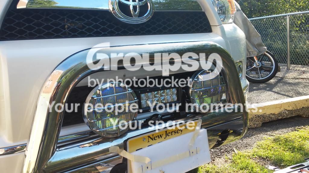

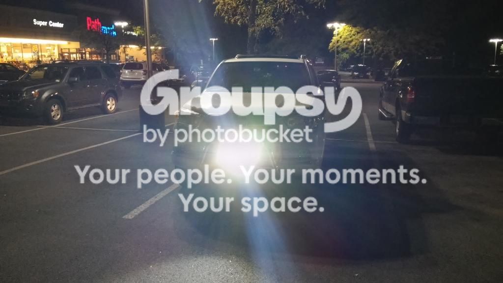

Now let's see the grill!

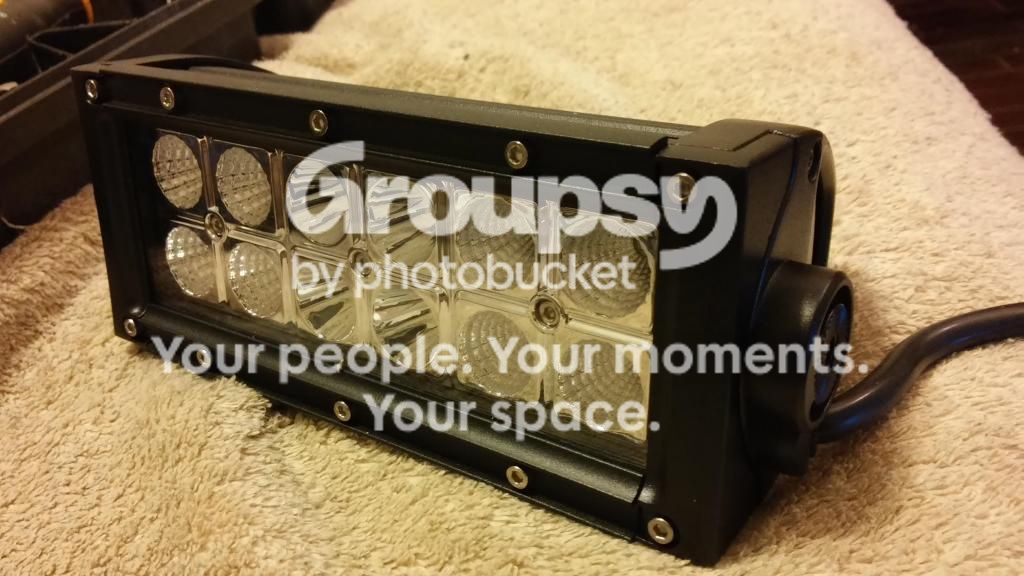

"And the OPT7 light bar all by itself"...
[MENTION=78273]Jeremy556[/MENTION] was right... the intensity of the small (8 inch) lamp is incredible! I hope that someone looking for a 'Rigid LED' alternative will at least consider the 'OPT7 C2 series'. There built 100% in the USA, cost is about 1/3 that of the BIG names, come with FREE S&H, 50,000 hrs life span, 5 star reviews, GREAT C/S and a comparable limited warranty!OPT7 C2 Series 8" Off-Road CREE LED
