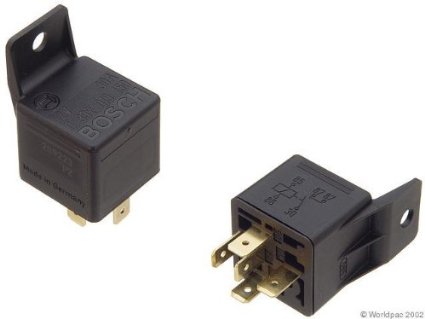

Hey [MENTION=83083]rigtec[/MENTION],
My 2 cents on the diode question, will a non diode relay work perfectly fine, absolutely. But, with modern automotive electronics, I prefer to use relays that incorporate a internal diode to prevent voltage spikes when relay disengages (turns off).
Relays without diodes you can A) solder diode to terminals on relay, or B) add diode to harness...........
I prefer internal opposed to external method because of corrosion issues.
Keep up the great work buddy!

I am curious as to why opt7 wired their relay backwards across 85/86?
I assume I could easily switch them (small pick for the retainer). I don't think they used a diode based relay, but that could be easily switched as well after switching inputs.
My 2 cents on the diode question, will a non diode relay work perfectly fine, absolutely. But, with modern automotive electronics, I prefer to use relays that incorporate a internal diode to prevent voltage spikes when relay disengages (turns off). ...I prefer internal opposed to external method because of corrosion issues.
See... this is what i love about this forum, I learn something new here everyday, Thanks Barry!
...and of course Best to you!
