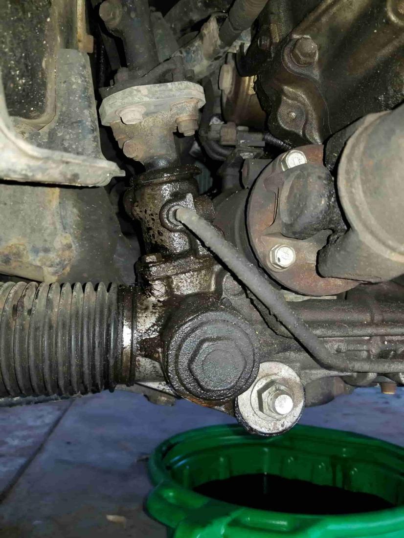

1998 4Runner with 208k. My steering rack has been seeping for quite a while, but its never been an issue. This last week, however, it seems to have formed quite the leak. I would ocassionally get a spot or two on the driveway, but now there is a full on puddle underneath. It seems to be coming from the boot at the top of the rack where the input shaft comes in.
So I see a lot of threads with people replacing them... Is that the only option? I'd really rather not! Can that top piece be replaced (the one that has the boot on it that seems to be the source of the leak)? I saw one person suggest leak stop ATF, but this seems to be flowing far to fast for that to fix.

If it is leaking from the boot on the power steering rack (or any boot on it) then replacing the boot will not fix the leak. The boot is merely there to keep dust and debris away from the seals. You likely have an inner tie rod seal leaking. If you take a pick and pierce the bottom of one of the inner tie rod boots close to the steering gear and fluid comes out then you have an inner tie rod seal leaking. While they can be rebuilt it's a much better route to replace the whole power steering rack assembly.
I had a similar situation with my rack when I purchased the vehicle. I noticed a bit of a leak in the boots and assumed I could just replace the boots. 3 months down the line the leak was much worse and after getting into things I noticed quite a bit of play from the actual rack. I am sure I went though water, mud and who knows what else with my boots compromised. At the end of the day, after quite a bit of research and discussion I went with a OEM Toyota rack with inner tie rods and got a pair of new outers as well. It was not cheap but I heard some horror stories of people putting in aftermarket racks only to replace them a year or so later. With that said my rack solved a good bit of my steering play and things feel much better after the swap and still very sold a year later.
This is a photo a took a month or so ago, before it started leaking really bad. I haven't gotten under there recently to check as its been snowing and raining a lot and I just don't want to get under there ha.
It is ATF, so its either the rack or the transmission, but I don't see any evidence that its coming from the transmission.
Also, I was probably not clear enough in my initial post. I said that it was leaking from the boots, but that could mean the boots on the sides that cover the inner tie rod ends. Its not that boot. I'm talking about the boot at the top of the rack, above the feed line, below the steering input shaft.
Is it possible to replace the part (not just the boot, its got to be a seal or something inside the input shaft) that is leaking?

Looks like my leak did - get ready to replace the rack and pinion. Odds are you have a leak at the top of the rack and pinion.

Most service techs, if they are honest with you, will tell you that attempting to rebuild the rack, or replace seals on it, will be, at best, be a very temporary fix.
If you end up deciding to replace the rack it is indeed a bit of a pain in the ass but definitely doable with a moderate selection of hand tools, lots of patience, and some elbow grease. I had mine out and the new one in over the course of a day, and I work slow. The new rack was ballpark $350 with a lifetime warranty from Advance. While you're at it replace the rack bushings.

Your rack is blown, buy an OEM one, though myself and a few others have had good luck with Detroit Axle. DO NOT USE CARDONE! I do this for a living and working for free warrantying crappy Cardone steering racks sucks!
One of my steering racks leaked in the same spot. I had another steering rack laying around that had a leaky ram, but the input side was fine. I was able to swap the good input on to my old rack. Took a bit of work, but saved me a bunch of money. I didn't have much luck with aftermarket racks, don't think I got much more than a year out of them (not sure the brand).
