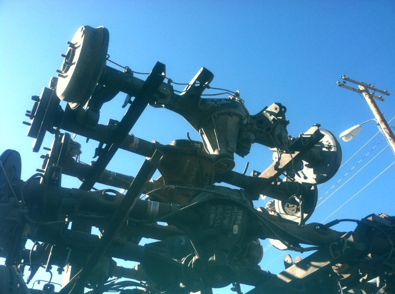

Here's a picture of it (not great). It's the axle on the end of the top bunk. Looks pretty good to me. Not sure how long it's been sitting out like that, or if rain has been collecting in unusual areas.

Leaning towards the complete axle at this time...and here's why:
Positives:
+ 85K brakes may be OK for a while...my current rear brakes are shot.
+ 85K wheel bearings and axle seals...vs. my 161K stuff.
+ Appears to be a lot less rust on this thing, so after a good cleaning and repainting, it should last a long time.
Negatives:
- I don't know the history. Brakes might be bad, bearings might be bad, diff lube may never have been changed. Although, photos of the wrecked vehicle show it was in pretty good shape (pretty clean inside).
- May not be the right gear ratio, although they have said it's 4.30.
- May not have ABS. Can anyone tell if it has ABS from the picture?
Those last two things are just my paranoia on how good the salvage yard knows their parts.
I'm about to plunk down the $725 + $200 freight on this thing, so I'm a little hesitant! :-)
