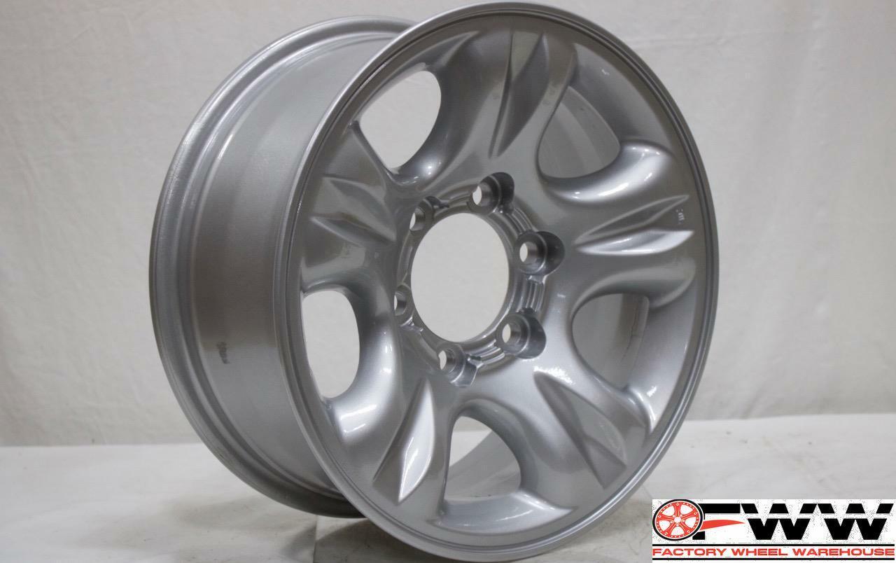

Hi all - I have a 02 Sport Edition and would like to put on original looking wheels. I have found some refurbished wheels - OE/OEM part number 4261135190 and Manufacturer Part Number 4261135181. Does anyone know if these are the correct wheels? Also which center cap and lug nuts were used? Attached a photo. Thanks.

Those rims look exactly like my 2001 sport rims and a spare set. I bought out of CA when I found out all 4 of mine were bent.. :(
Center caps are different than old style 1996 through 2000
They use the same lug nuts as the aluminum alloy wheels do.
Steel rims use different lug nuts then the alloy rims do.. :)

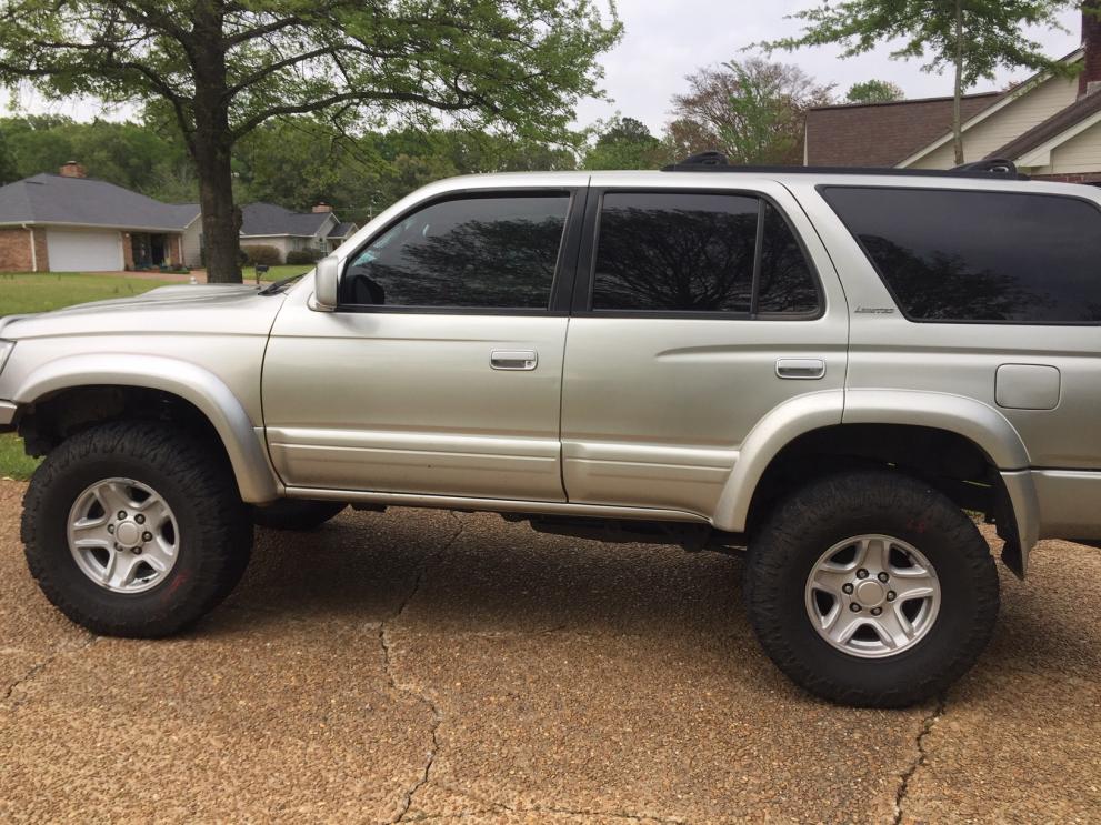

Those are the exact rims on my 02 Sport and I have no reason to think it's anything but OEM.
16" right?
Jason
Rim street name is coke bottle rims, came on 01-02's all of them. Look close at jgue467's center caps they are specific to MY's, lug nuts are same as any, any center cap fits.
Here is a sport.... here is the most common aluminum rim out there.
I don't believe a 15-inch alloy sport rim exists only 16 inches.
Will the common center hubcap snap on a sport rim. Probably, but I doubt it looks decent. :)

not sure about part numbers but as far as looks go those are them...
01-02 limited edition 4runners typically came with those "coke bottle" wheels...

Thanks all for the input. I spoke to the local Toyota dealer and they said that those rims were obsolete. Toyota Parts Direct has them on their site but when I inquired, they said that they were no longer available. So, unless I can find some used ones in good shape I am out of luck.

Has anyone found the part number for the wheel caps that fit on the coke bottle 5-spoke wheels? I know this is a different part # than the caps for the 5 star or the split spoke, and will not fit interchangeably.
I found a set of coke bottles and had them powder coated silver. They look awesome but the center caps are completely chipped up. Would rather buy new than paint myself...just don't have time :'(
Alright I have confirmation for the center hub cap for the coke bottle 5 spoke from the '01-'02 sport edition, also seen it called the flower 5-spoke. I ordered a set and they arrived today, they are correct for the coke bottle sport wheels.
It is Toyota part # 42603-35760
This will fit only the coke bottle, not the 5 star or the split spoke.
