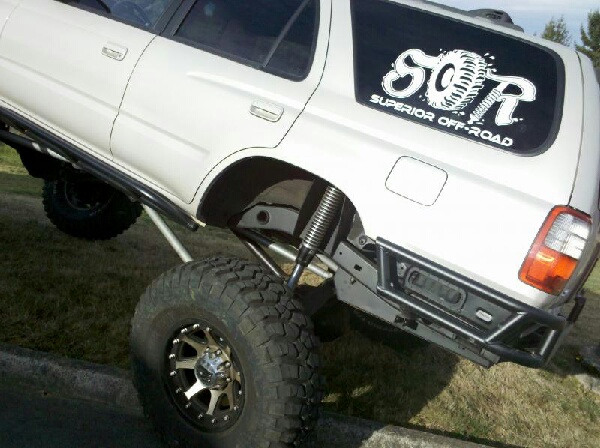

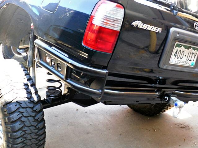

Anyone have any suggestions on how to go about it? Or why not to do it? For those who don't know what I'm talking about here are a couple pics of others rigs.

Someone sells a mount that you can weld on the outside of the frame. There are a few guys who have done it, their names just aren't registering now. I know, lots of help. I'll see what I can find.
I like what ripcord did but I'm thinking something a little more like the white one. Can't seem to find what towers he has. I like how they are more or less frenched into the frame. When I do the ford tank swap I plan on 4 linking the rear and either going to struts like the white one or coilovers so I need a nice sturdy setup to go off of in the future.

Not sure why I didn't think about this before ran them in the front of my old first Gen. Found the build on the first runner and looks like he made his own mounts. Here is a link for anyone interested. Superior Off-Road's 4Runner Build - Pirate4x4.Com : 4x4 and Off-Road Forum

The ones I posted are designed to be frenched into the frame so the tire has less chance of contacting the shock and have a wider width for coilovers. Not sure if the ford towers would be up to the task. I have seen the tower litteraly rip in half could of been from bad welds or faulty material.
