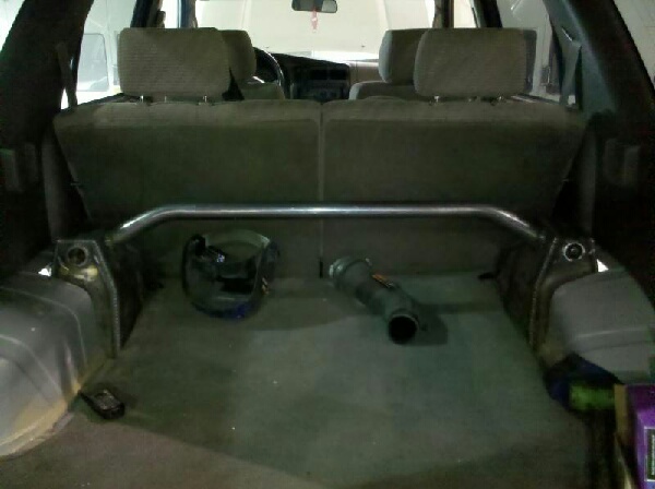

So I think I am going to do the frenched in towers and something like pictured for stiffness. Just need an idea of how to seal off back there. Was also thinking of instead of the cross brace integrate it into a roll cage.
