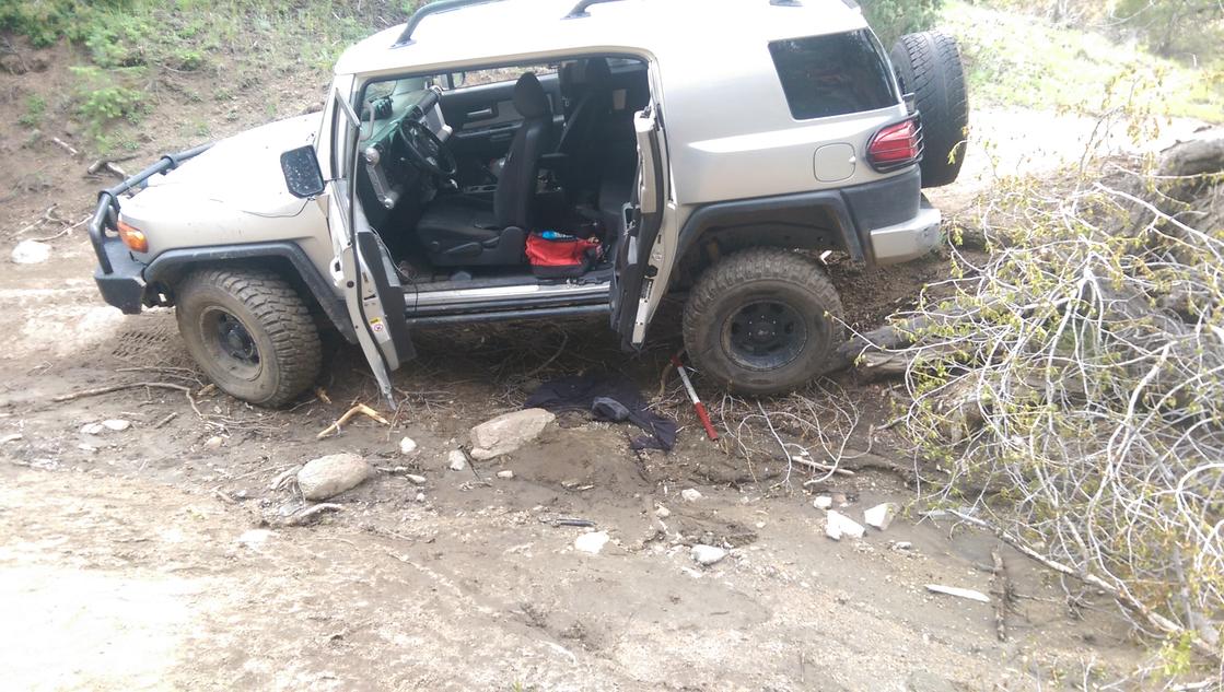

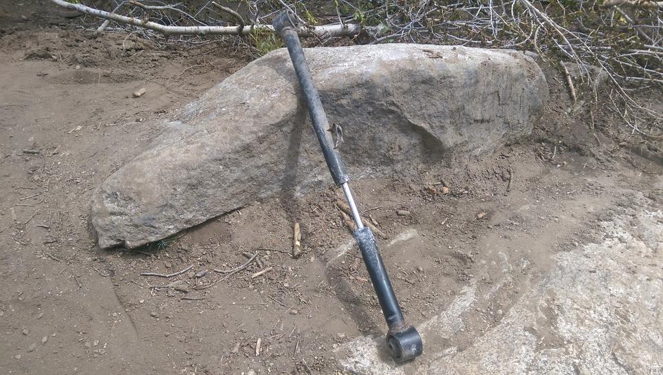

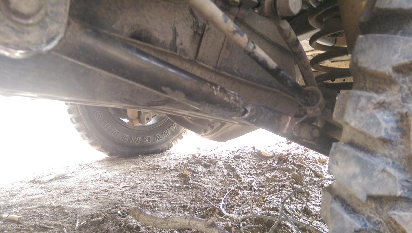

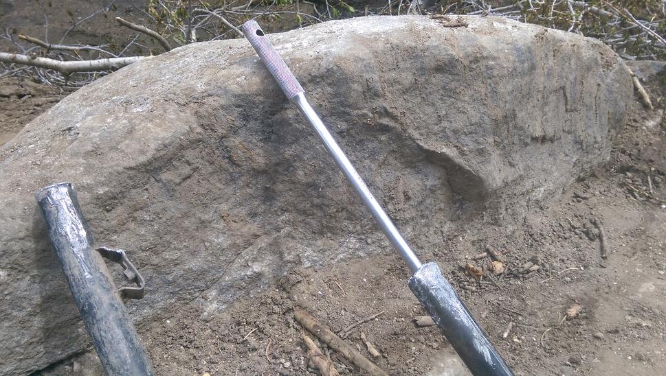

So my buddy with his OME lifted and locked FJ with arb bumper and winch decided to follow me up Chinaman Gulch here in CO. About almost half way through he had lost his rear left lower control arm along with some other damage. We did a trail fix that worked pretty good. Used a 1/2" break bar and ratchet strapped the axle to the truck.
We turned around and by the end of the trial he had two broken lower control arms, bent sway bar, sway bar links, quarter panel damage, exhaust damage and lost the rear right bumper cover.
