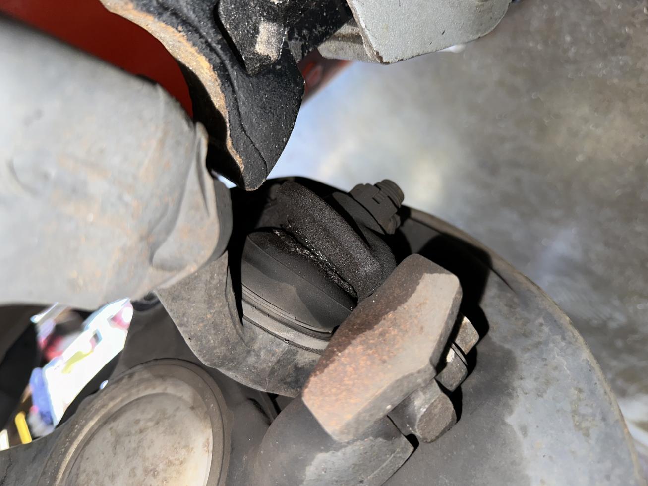

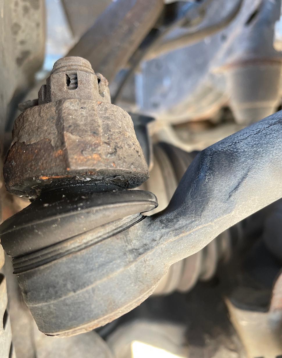

Hello everyone, do you guys know if I should replace my outer tie rod. There is no play on movement just some grease exposed.
Thanks

It's fine. A little grease leak is OK. The grease that seeped out was excess in the boot above the joint. My tie rods have seeped a little bit more grease than yours after 128K miles and I will not replace until wear is evident. My lower ball joint boots are showing wear, however the joint itself is still OK. It's a good idea to check front suspension components for wear once a year and more often if you off-road.

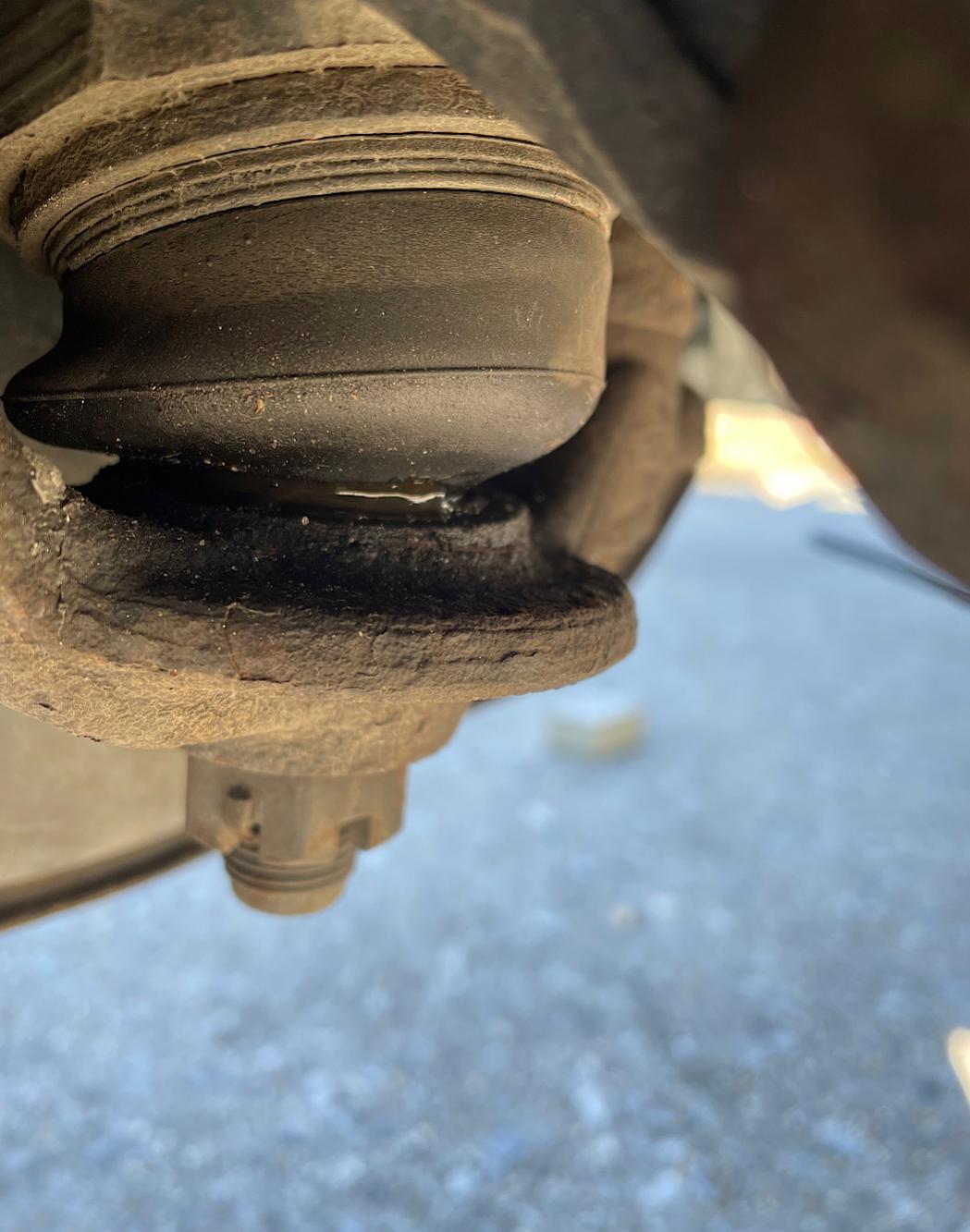

That’s my LCA also exposed grease. Yes outer is easy to replace and money wise vs lower.

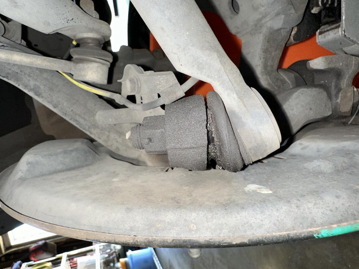

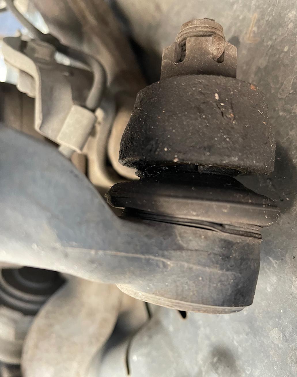

This is my outer tie rod and lca ball joints look like. 9 years of use. No off roading.

Exposed grease could be a sign of a failing boot, but it doesn't necessarily mean an immediate replacement of the outer tie rod. Give the boot a once-over for tears, cuts, or major wear. If it's just a small issue, you could clean up the joint, slap on some new grease, and throw on a new boot. But if the boot is seriously messed up or the joint is looking pretty worn, it's probably a good idea to go ahead and replace the whole outer tie rod.

wasn't any play in mine after 80K but seepage. I replaced just rubber boots on tie rod ends and ball joints. Japanese rubber deteriorate faster than metal wears out. change it proactive to avoid contamination of grease and wear joints. same is for front axels boots, and more expensive: steering rack. although latter more complicated and may require alignment tor toe. my point is: it start leaking or seeping grease - replace boot.
