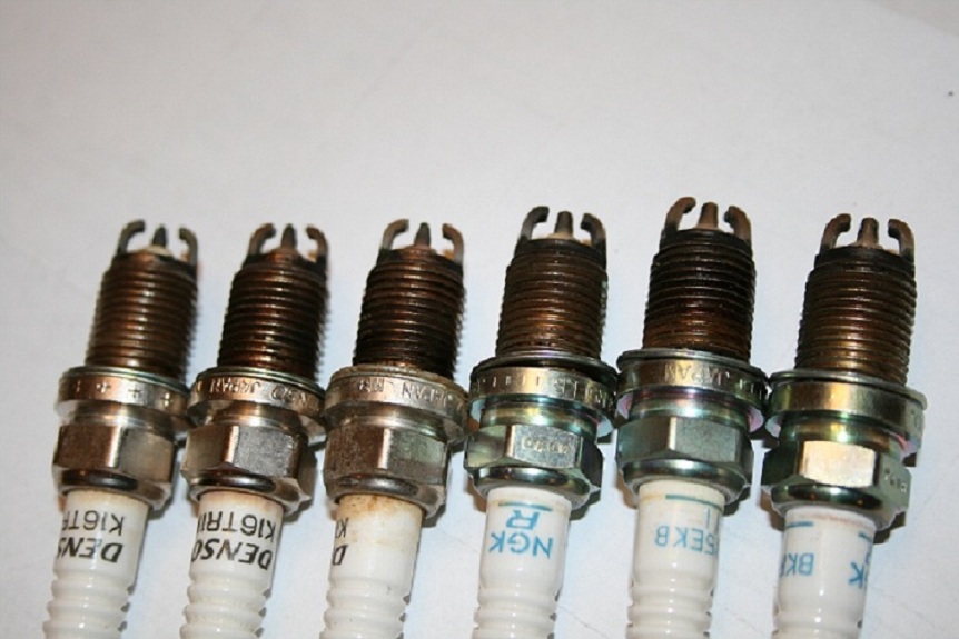

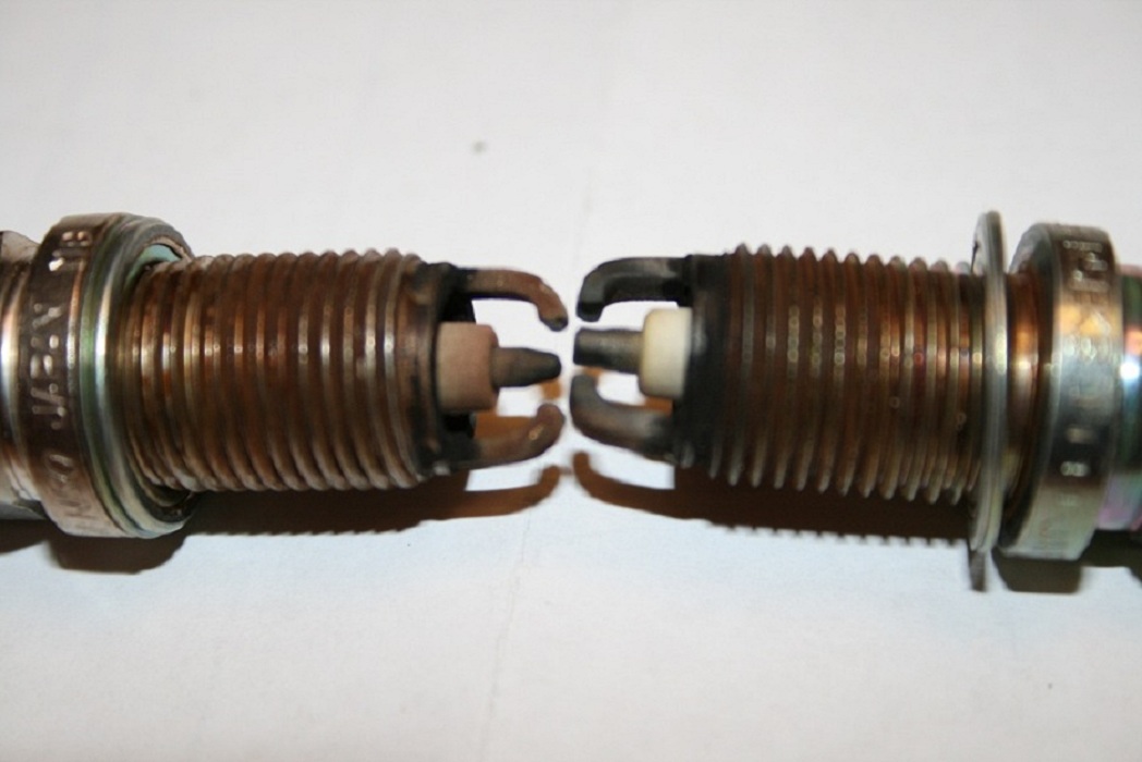

Here is what NKG and Denso look like when you wait 103,000 miles to change OEM spark plugs. I was under the impression from reading the OM that the v-6 was the same as the v-8 and didnt have to be changed until 100k. I quickly learned from this forum that they needed to be changed was sooner than that ...at 30k
Look at how big the gap is..looks like about a .80= not good
