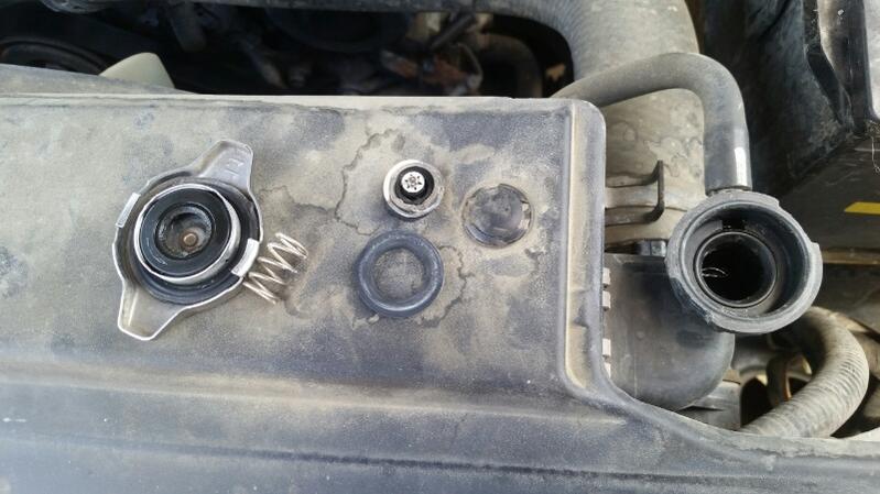

At home I saw the radiator cap is damaged (see pics). The dipstick oil looks clean. The oil cap oil residue is normal. I am hoping I just missed reconnecting the reservoir cap and no real damage was done (praying I didn't ruin the head - I just replaced the head on my wife's 4runner when the coolant line ruptured on the EGR and warped the head). I plan to have the timing belt, water pump, and thermostat done asap and I am replacing the radiator cap. I'll ask them to pressure test the coolant system too. Anything else to do? Think it's safe to drive in the short term until I get the work done next week?

It took 5 liters of water? Did it look like that much coolant suddenly came out when your temp gauge spiked, or was it so low for some time?
A broken radiator cap could theoretically cause boil-over because the system loses pressure, thereby lowering the boiling point of the coolant fluid. However, a sudden temp spike from normal to redline could indicate something more sinister.
I'd start by replacing all the coolant fluid and water with proper coolant and installing a new radiator cap and that hose that came loose to see if it still overheats.
Might be a good idea to check the spark plugs to see if one is wet and peek inside each cylinder for signs of coolant infiltration through the head gasket.
I think you should drive it a while as is but with a new radiator cap until you see that it doing OK and not overheating again and no damage was done when it overheated, then proceed with doing the belt, water pump, etc., be sure to keep a couple of gallons of water with you until you know it not losing any more coolant
I'm thinking this all happened because the cap failed, if you have ever taken a cap off when the engine is hot then you know why a lot of the coolant boiled out into and then out of the reservoir, 5 liters is not out of the question when this happens especially when it overheats at the end, but I think you may have lost the coolant over time until it was too low and then rapidly overheated blowing out even more coolant.

If the cap was bad, it might not have been letting coolant from the reservoir to the radiator. Little late but you should have been checking the radiator coolant level instead of just topping off the reservoir. Hope it's ok.
I think that 5 liters of water in the coolant will contribute to excessive heat. Also, if this wasn't distilled water, I'd want it out of the system as quickly as possible, especially with such an old radiator.
While the engine light is on, see if you can download the codes.
PS. I just looked at your photos again, and there is no pink residue anywhere. Are you running something other than Toyota Pink in the cooling system?

You are not the only one...my 2003 V8 did the exact same thing this past summer. Bad radiator cap and started redlining, filled it up, just kept boiling and disappearing...I think all I did was replace the cap and make sure to refill the coolant. IT SCARED THE HELL OUT OF ME
I was running Xerex pink asian coolant, not the Toyota brand, but I think they're basically the same.
You know, it was weird. I added most of the water to the reservoir, so it was clear. Then I added a liter straight to the radiator. I had trouble getting water into the radiator because of the broken cap parts (I fished them out at home, just couldn't see well enough while roadside). Anyway, at one point, the radiator seemed to dump into the reservoir, and the reservoir fluid turned pink. Then it all disappeared from the reservoir again (into the engine, I guess).
I added Dasani water - nothing but the best for my truck, lol (a case of it was all I had). I plan to flush it all out when I get the radiator cap.
I think all the coolant blew out of the loose reservoir cap-tube and maybe also the broken radiator cap. I must have forgotten to reattach the reservoir cap last time I filled up, unless the boiling blew it off. :frusty:
