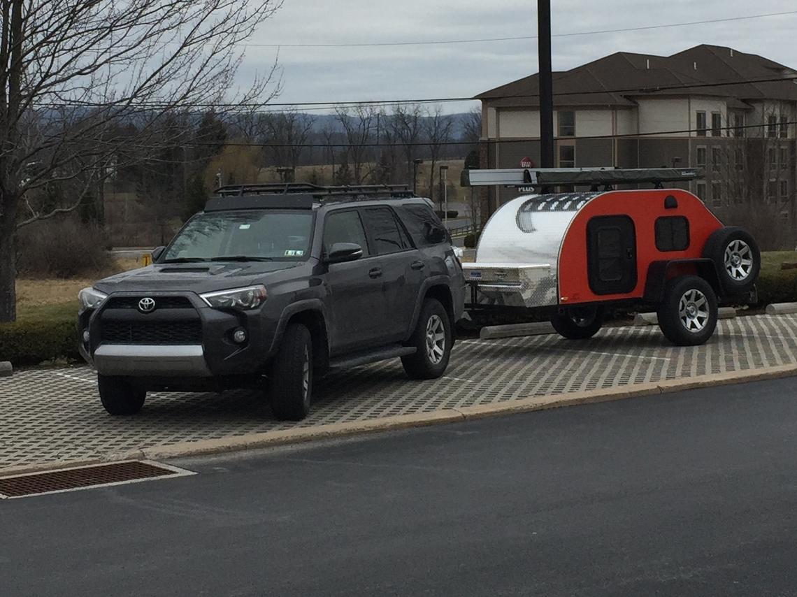

Hi All,
Can anyone offer advice or opinions about an “overland suspension”. I’ve seen plenty on the forum about lifts”— aesthetic and functional — off roading, rock crawling, etc., but less about what, for lack of a more specific term, I’ll call an “overland suspension”
Let me be a bit more specific: I get to live an overland lifestyle with wife and kid a few month during the summer — this year It’ll be East coast to Arizona to California to British Columbia, and eventually out to Newfoundland (and back), all the while looking to get as far away from civilization as possible — while the rest of the year I drive lots of highway miles with a mostly empty rig.
I’ve made a few slight mods to my 2016 4Runner TE with KDSS: a full set of aluminum underarmor from RCI, a stealth Gobi rack, and soon an undercover hidden winch mount (and winch). The weight adds up, especially when the the rig is packed. Finally, I often tow a custom built off road teardrop trailer (see pic).
…by now I wonder if I’m beginning to over stress the stock suspension. I’ve thought about small fixes like spacers, perhaps a set of Bilstein 5100s up front (thanks to everyone’s excellent advice in this thread), but maybe I should think a bit bigger? A moderate lift (1” or so?) and/or adjustable (stiffer) suspension to accommodate both offroading and daily driving…an “overland suspension”? (Nothing big...I'd like to keep the overall appearance as close to stock as possible)
(I did find this, but can’t tell if it’s an advertisement or an honest review).
Thoughts?
Many thanks in advance for your advice!

Seems like Air Bags would be a good choice to give you the extra weight capacity when needed, but not make it too stiff when you don't. Check out this thread, right in the first post: http://www.toyota-4runner.org/5th-gen-t4rs/92013-antmans-thread.html#post806239
Second the vote on air bags. Great way to firm up the suspension when needed. I have the identical truck as you and my overland setup is Trd pro shocks up front with .5" top spacers and 5100's in the rear with Firestone air bags. Simple, great on road and with the slight lift in front I now run some super challenging and fun class 4 roads in VT with confidence.
A mini-overlanding trip with the same gear you'll take wouldn't be a bad idea to test what's necessary and what's not. The more you modify (and go aftermarket), the less the reliability.
I think Airbags are a good suggestion for the rear but if you're going to add a winch you'll want something up front too. 5100's with OME springs will net about a 2" lift and help with the weight. You could also do the bilstein 6112's up front if you wanted to spend a little more $.
There is also this option if you haven't seen it.
http://www.toyota-4runner.org/5th-gen-t4rs/231576-dobinsons-5th-gen-toyota-4runner-suspension-options-lots-choices.html
You can run their springs with the Dobinson shocks or with 5100's.

Sorry, I don't have any advice for you. My wife and I also tow a TC Terdrops ORE and we have an icon lift with the "regular" rear Icon springs and we get a little bit of sag as well. Airbags are an option, but I was told that the airbags would limit offroad travel when used. We are in the middle of building a box for the back of the runner that will hold recovery gear and may install OME medium springs after this.
Here is one of the most informative threads I've found regarding the differences in rear spring types:
http://www.toyota-4runner.org/5th-gen-t4rs/147846-most-stiff-rear-springs.html
Here is an example of the slight sag we get when fully loaded:
Airbags if your ass is sagging but the best advice is always to leave it alone and learn what exactly you will need for YOUR situation.
Your truck is already more capable than the driver and trust me that your suspension will let you know if it needs anything, just like your undercarriage will yell at you if you don't have enough clearance for where you drive.
I wouldn't worry that you're over stressing your suspension. These trucks are designed to do what you are doing with it. I would leave it alone and enjoy the extra money in your pocket. If things start wearing out, that is when I would look to upgrade. These things are incredibly capable in stock form.
with armor, rack, winch&mount, tounge weight its possible he could be over GVWR if he is travelling with passengers and gear, in that case suspension upgrades are worth it over stock equipment
my bad, here is a picture fully loaded post lift, and we had the shop leave a tiny bit of rake in to account for towing:

OP, like everyone else said, find out what you actually need and go from there. There's no real thing as "overland" suspension, many people have different perspectives on what works for them and what doesn't. [MENTION=129593]MTN4RNR[/MENTION] and some others have gone the stock suspension route, [MENTION=89562]bimrunner[/MENTION] [MENTION=49966]mikey's2010SR5[/MENTION] and [MENTION=124732]LawnDart[/MENTION] have gone long travel. You can overland with almost any kind of suspension. Countless others have done setups in between.
I'll also agree with everyone who said that most "overland" travel involves paved surfaces, and heims, uniballs, and other aftermarket compenents usually require a rebuild before their OEM counterparts. Keep that in mind when choosing what parts you are going with.
FWIW I had great success with my old Bilstein 6112/5160 setup until I really started loading down the rig. I think it's a really good bang for the buck if pair it with the right springs.

That link is not an advert, but the reality for you may be different. Everyone has different needs and wants. There is no one right answer.
For me its about keeping things simple. I want to know I fix things or find parts anywhere I end up. It sounds like you are planning a very long trip.
Something I do is call local auto parts stores on my planned route. Pick a few small towns and call asking for a replacement shock. See if they can even get something what would work. If you are outside the USA, you never know what you'll be able to get without crazy shipping charges.
If you really want to keep things simple and easy, go with a moderate OME package.
