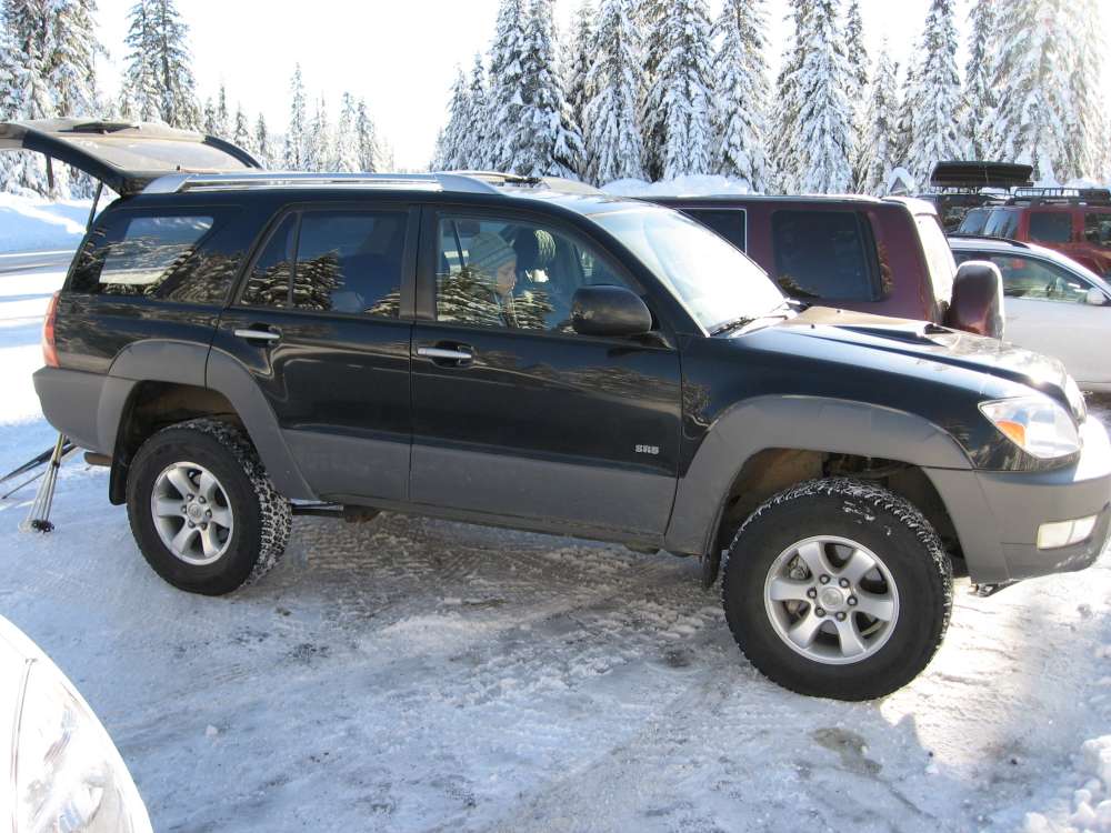

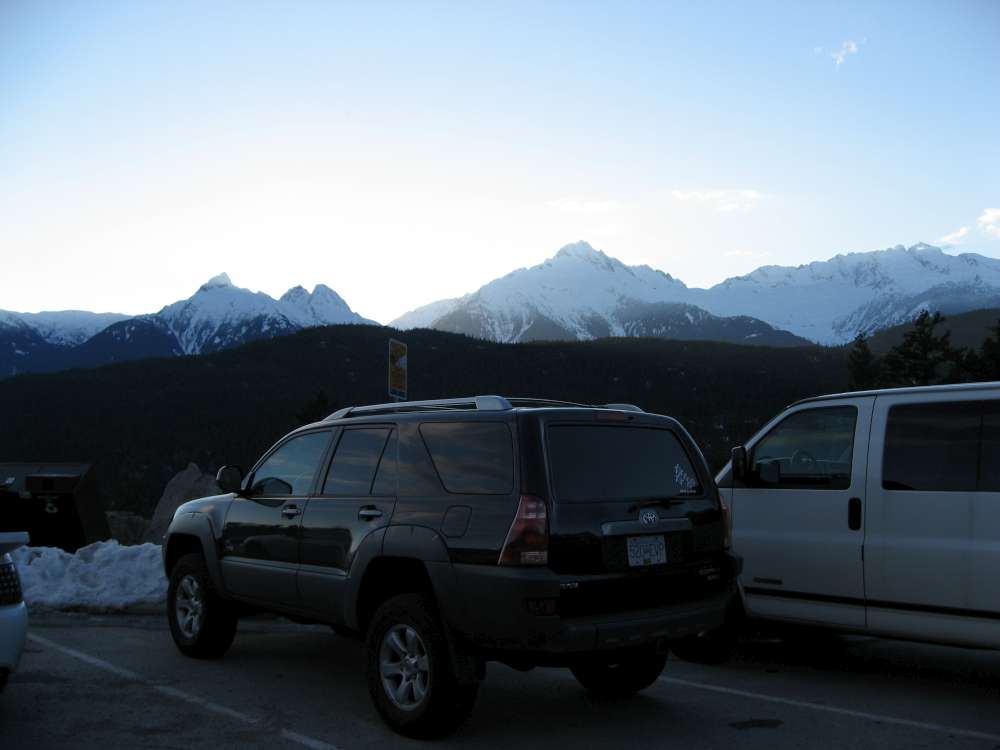

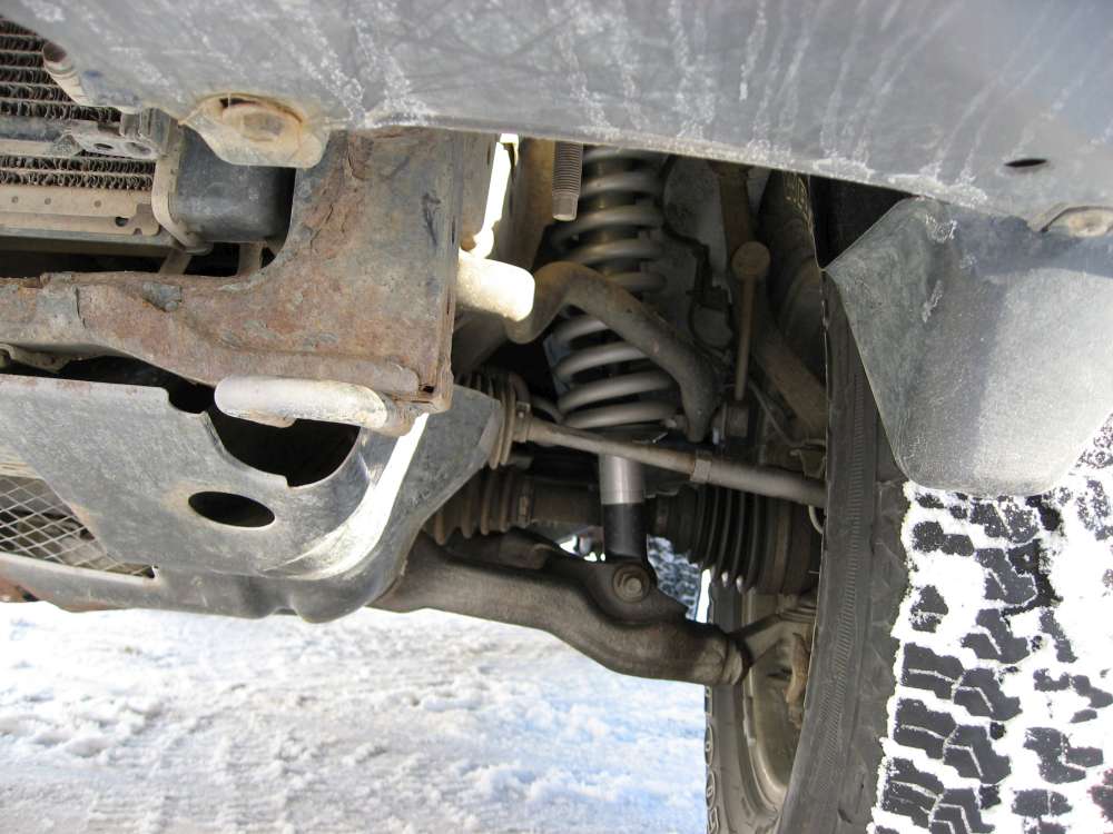

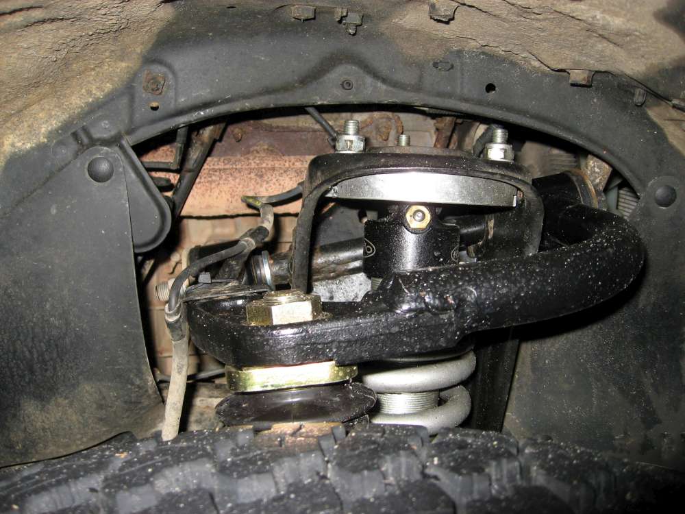

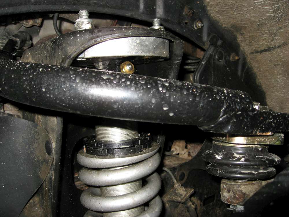

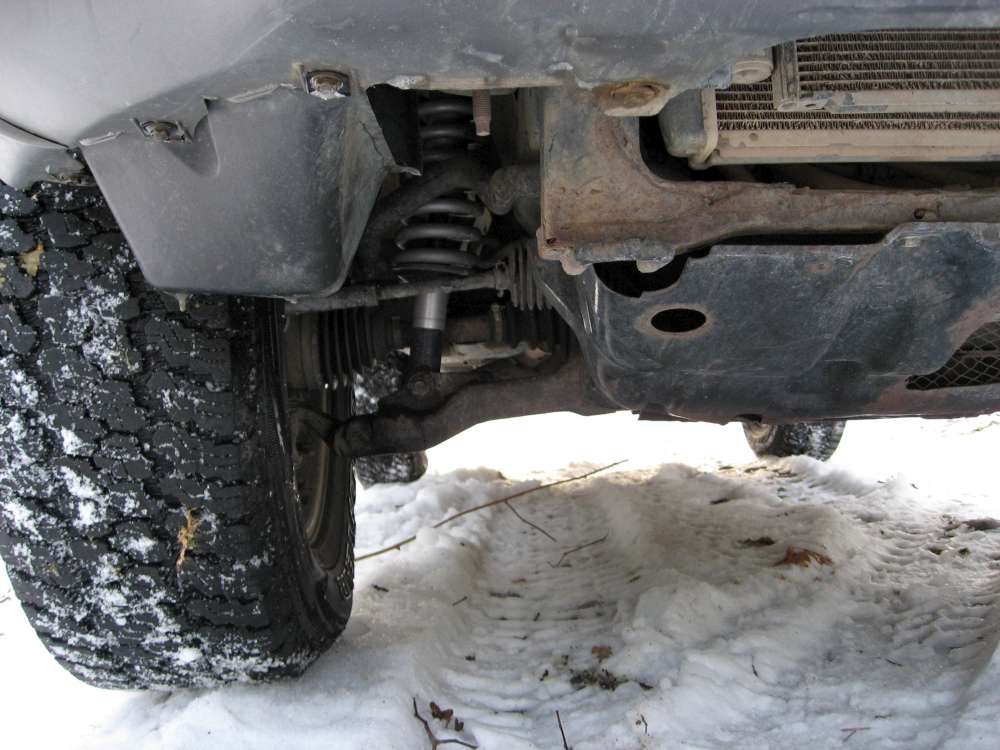

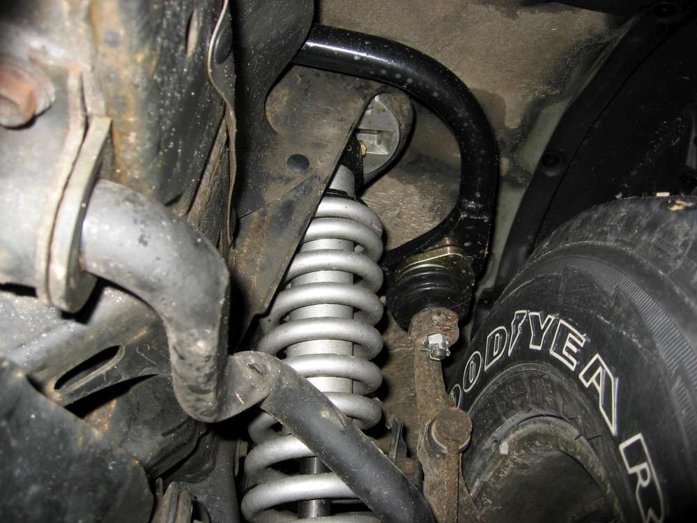

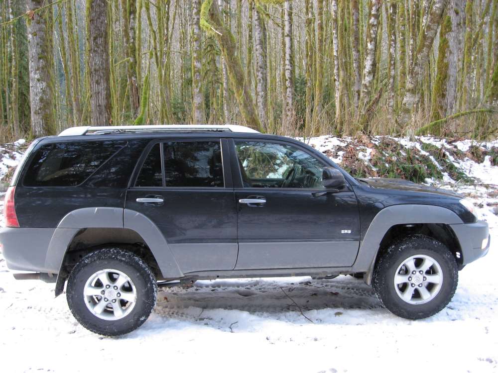

Here are some long overdue photos, with the LR UCAs.
Rust is definately a concern for me but I'm just going to have to keep Boeshield on them. I've never used it but I've read good things. Regarding performance my real concerns are that highway performance doesn't get worse - the 4Runner's have such tight stearing. I'll widen the wheels with either new rims or spacers too but I don't know how much that really compensates for height.
Nice truck though, I like the higher stance.
