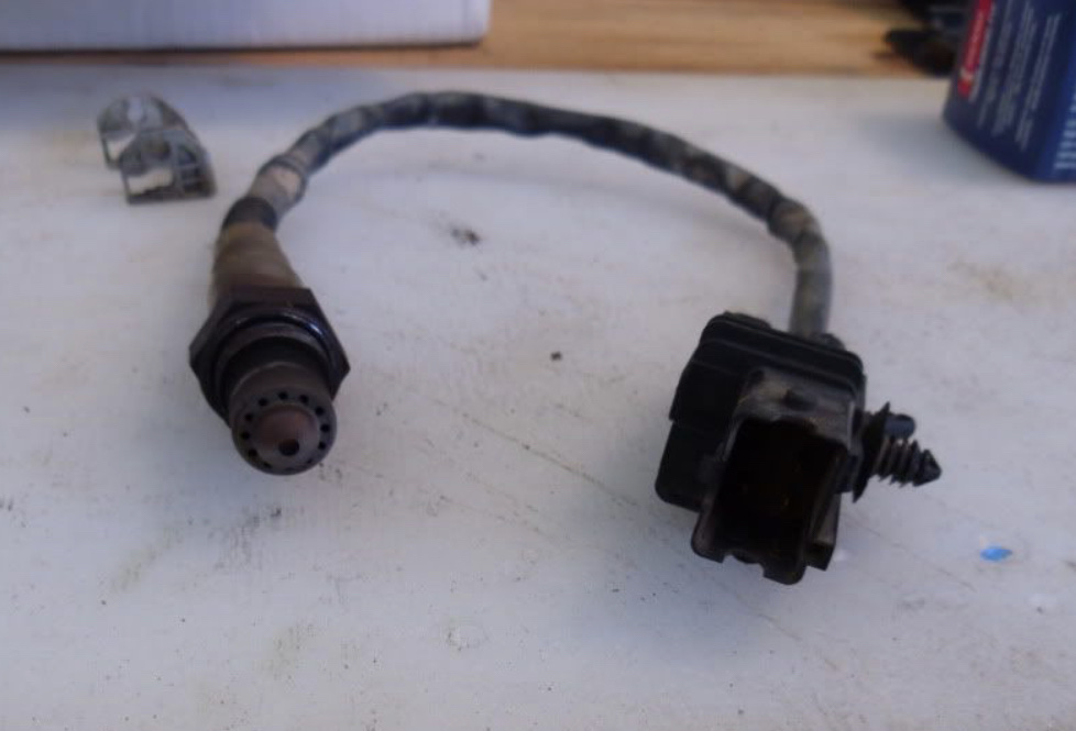

I have a 1997 Limited (stock, no lift, 265/75 R16s) and have been troubleshooting a variety of annoyances, including a P0130 and low gas mileage (getting around 11). I replaced both the front and rear O2 sensors with the recommended Denso parts (234-4154 and 234-4162), and saw no improvement. If anything, my MPG seems to be slightly worse, but it may be in my head. I’ve cleaned the MAF sensor as well.
What I found strange was that the O2 sensors did not look like the sensors shown in every O2 sensor pic I’ve seen (stole a pic off the web, as I didn’t think to snap a pic of mine):
One had a longer cable, as expected, but both looked like the picture above, rather than having the longer 1” sensor tube.

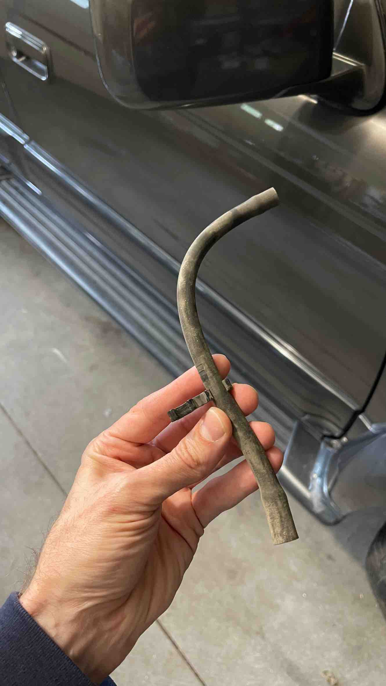

Since replacing these, I’m consistently seeing a P0130, which got me checking my vacuum hoses. Strangely enough, I found a hose in my engine compartment, not connected to anything, and for the life of me, cannot figure out where it goes. It could be a prior mechanic replaced the hose and accidentally dropped the old one, or…? Does anyone know where this one should go?

Just curious, any thoughts on the vacuum hose?
Nice. Thank you for confirming. I really appreciate the info!
You're welcome. The size makes me think it may have something to do with the charcoal canister/evap stuff on the driver side of the engine bay
Excellent - thanks. Well, I know what I’m doing when I’m done with work for the day!

Interesting. Well, I picked up a new Denso 234-4162 and the difference is noticeable. The error is gone, my instant MPG is noticeably higher (watching my Ultra Gauge), and after a number of long drives around town I’m seeing a significantly higher average MPG. Looks like I got either a defective of counterfeit sensor.
Still no idea where that hose came from, but my initial problem seems to be resolved.
Regarding staying open loop, according to my Ultra Gauge I’m staying closed loop, so I think I’m good there. Looks like a bad sensor…
