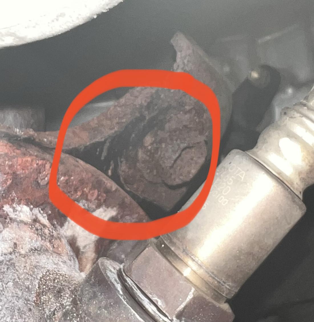

I also have been getting p0430 code as well as the VSC TRAC and VSC OFF lights on the dash. I just bought the truck, ‘04 Sport Edition 4wd w/203k miles. The prev owner said that the code was an O2 sensor but my technician says the Bank 2 CAT is bad. The downstream sensor seems loose, washer shakes, and it looks to have an exhaust leak at the junction just prior to the O2 sensor. Could a leak there cause a prob and trip there code? I’ll keep trying to upload a pic, but there looks like black burn marks on the flange and the support/nut is rusted when literally nothing else on the undercarriage is.

Yes an exhaust leak can do this. Fix that first. I was getting a similar code maybe once a month but after fixing my exhaust leaks getting this code is now rare for me. I wouldn't go swapping the cat yet. BTW, the OEM cats are worth some money to recyclers if you do end up replacing it.
