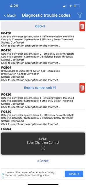

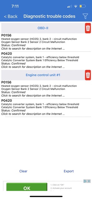

Fix try #1 - I've bought a bluetooth OBDII scanner and cleared the codes when they come up (first couple months of DTCs). The codes/lights would go away for a few hundred miles but eventually come back up. Original codes were P0420, P0430, and P0504.
Fix try #2 - Add Dorman spark plug fouler spacer to bank 2 rear O2 sensor as this is what most 4th gen V8 owners on this forum suggested to try to "trick" the secondary O2 sensor from pulling the codes. DTCs P0156 heated oxygen sensor 2, bank 2 - circuit malfunction and P0420 came back shortly thereafter.
Fix try #3 - replace bank 2 O2 sensor with new DENSO O2 sensor ($50) along with Dorman spark plug fouler spacer. P0420 code returned
What next? I haven't replaced the rear bank 1 O2 sensor but added the spacer, like I did on bank 2, but wondering if that will even fix the DTCs or if it's something else. More than likely, I'm just ignoring the true culprit - cracked exhaust manifold - because I don't want to spend $2,000, but hoping you can help me definitively find a fix.

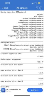

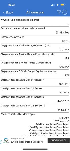

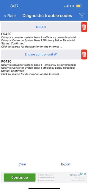

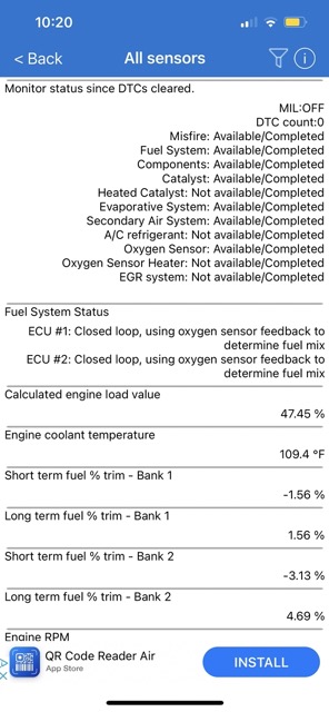

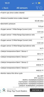

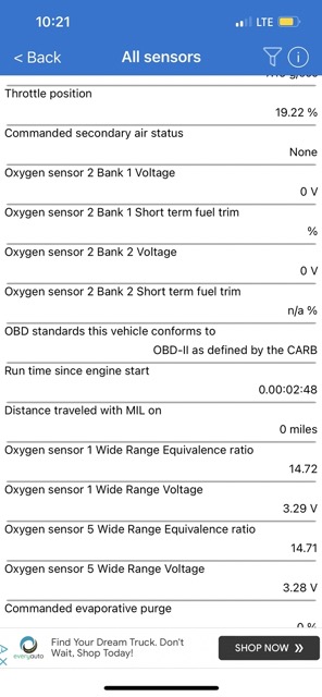

I've added some screenshots of the previous trouble codes as well as catalytic converter temperatures, fuel trims, wide range equivalence ratios/voltages in case that helps. If I should look at any other areas of the OBDII scanner for values that could help track down the issue, let me know.

An exhaust leak towards the front of the car can make for the cat codes as can a cat that is on the way out. I don't see how you'll get away from the p0420/430 without replacing the leaky manifolds unless you completely block the downstream o2's. These seem to often leak at the y-pipe center connection too. P0504 seems to be a brake switch malfunction.
The P0504 code has not come back since clearing the DTCs and the repair for that seems straightforward - if/when it comes back.
I included screenshots of the temperatures of the cats as I thought if a cat was failing it would run at a different temperature. Both values for primary and secondary cats are pretty well in line with one another. I'll check a leak at the Y Pipe connector, but seems pretty solid to me.
