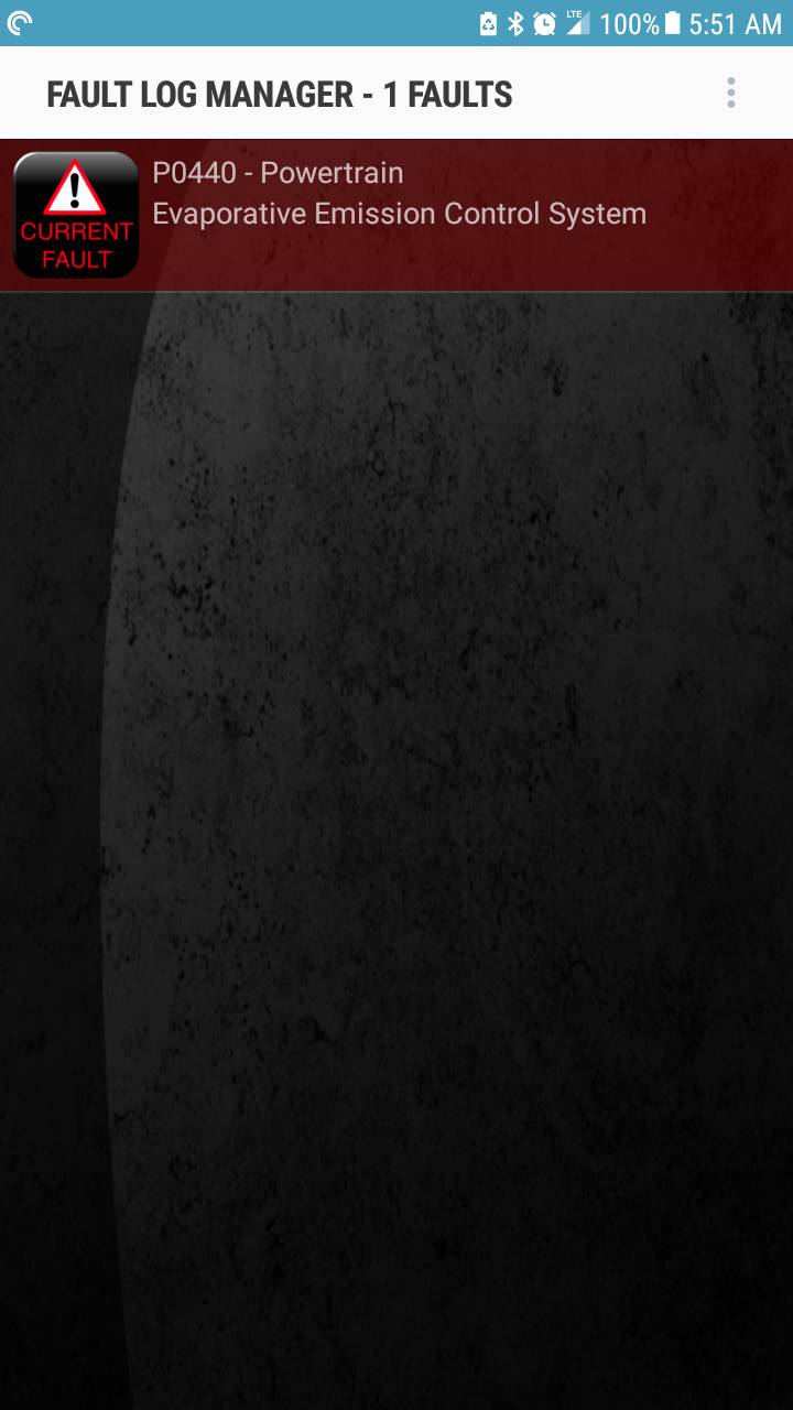

P0440 what's the fix
Brute1100
I get this code once or twice a tank of fuel. I'm not too worried about my emissions, in Texas it's a non issue. But making it never come back would be nice as well.
