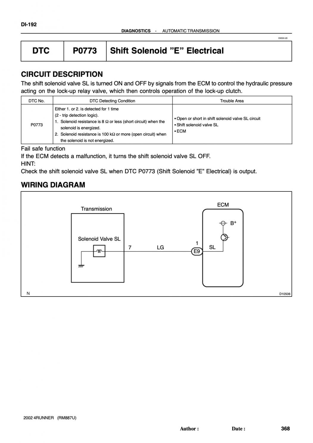

Thanks for detailing your experience. Fortunately, your unfortunate experience was timely because I started experiencing a similar situation about 2 weeks ago. The code comes up as electrical and not malfunction (mechanical), so I was a bit worried that the ECM had decided to take a nap or some other wiring gremlin. I visited the local pick n pull, which had an 2002 SR5 and pulled three AISIN solenoids. Drained my transmission (looking a little too brown/grey), replaced all three solenoids, cleaned the solenoid connections (was coated in transmission fluid), added fluid, flushed out the remaining fluid in the converter via cooler supply line, and topped her off. The light went off immediately on starting.
I took her for a test drive and it shifts even smoother than before. All in all cost me less than $40 to fix this issue. I feel good about myself. I couldn't figure out which one was Solenoid "A", so I just replaced all of them. I recommend cleaning the solenoid connection located to the left rear corner of the transmission. If replacing the solenoids, cleaning and or replacing the connection doesn't work, you've probably a problem with your ECM. I've added the pages associated with P0753.
Similiar procedures can be followed for:
P0750 - Shift Solenoid "A" Malfunction
P0755 - Shift Solenoid "B" Malfunction
P0770 - Shift Solenoid "E" Malfunction
P0753 - Shift Solenoid "A" Electrical
P0758 - Shift Solenoid "B" Electrical
P0773 - Shift Solenoid "E" Electrical
