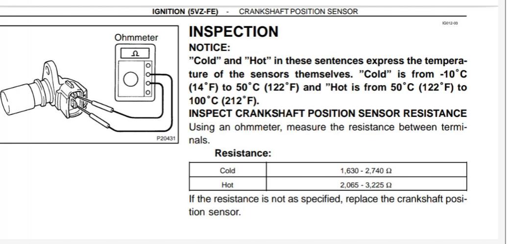

Check the resistance is in spec.
saw this on the toolmans videos, everything checks out.
