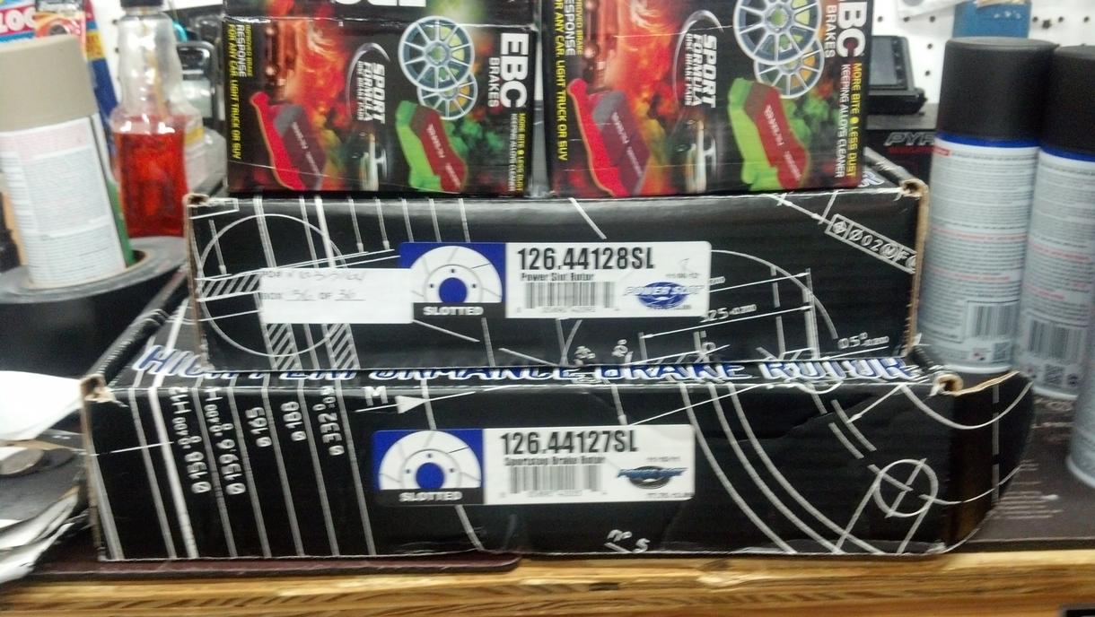

I just did rotors and pads last weekend. 2005 sport edition... and that night I felt like a had wrestled a bear. The model numbers are for the bigger rotors on the sport edition. The pic shows the left side rotors in box.
Centric: Power Slot
126.44127SL
126.44127SR
126.44128SL
126.44128SR
Front Pads: EBC Brakes DP6993 6000 Series Greenstuff Truck and SUV Brake Pad
Back Pads: EBC Brakes DP71657 7000 Series Greenstuff SUV Supreme Compound Brake Pad
If it helps, I did a lot of searching on this, most folks are running Centric, EBC or OEM... and all kinds of combinations of pads. Really just depends on how much money you want to spend.
