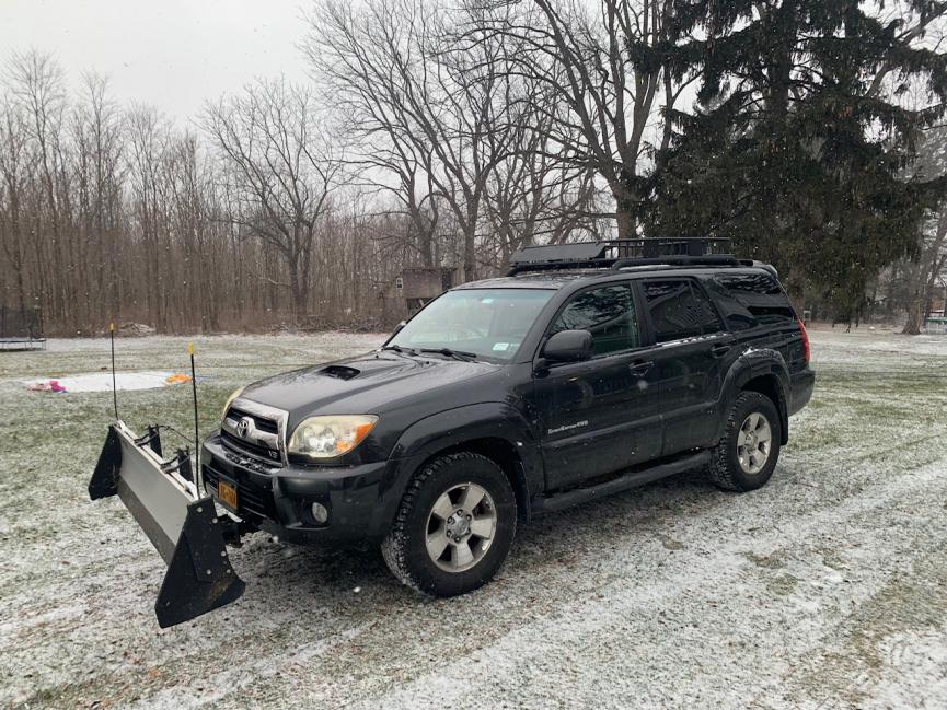

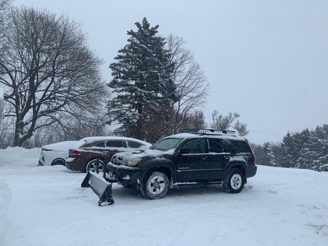

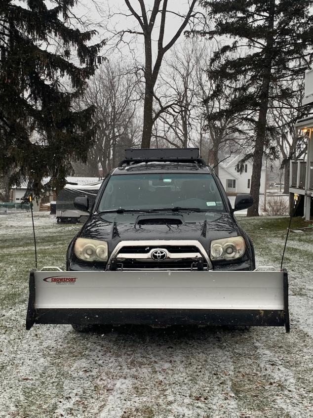

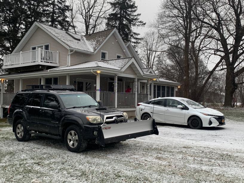

I uploaded 4 pics. It's a snowsport personal plow. I luckily found the plow + front adapter on craigslist used locally and picked it up for about $800. So the only part I had to buy new was the front hitch and have it installed which was done very reasonably by our regular mechanic. I leave the front adapter on all winter, but really only put the plow on to plow with. Then I take the plow off by hand and set it next to the house. Obviously if I really wanted to, I could remove the front adapter in about 3 mins, but it feels cool to drive around with a battering ram on the front of my 4R lol. After 2-3 seasons I bought the $25 downward pressure strap, it actually makes a really big difference. SnowSport Hold Down Strap | 60220 Agri-Cover Pressure Strap.

Cool, beats shoveling. Post #6 in the link below is my rig. The white strip on the bottom was temp metal before I repaired a couple rust holes. I love the work that thing can do.
Fisher Snow Plow Mounted on 4Runner
Nice looks great, you definitely have a far wider range of skills than I do. You were able to design some pieces and weld. I was really looking for a very straight forward "plug and play" style solution. At times I wish I had something more extensive, other times I'm glad for the simplicity of putting it on and off by hand in about 1-2 minutes. Pros and cons to it all, but like you said, the range of work the 4R can do is amazing!
Thank you for the kind words. I modded it so it comes off super easily like Fisher's MM2 setup. I enjoy building and modifying things out of metal to suit my needs. It really wasn't that hard to modify the receiver bits to fit the 4runner, I copied the setup that Fisher used on the early Tundras.
