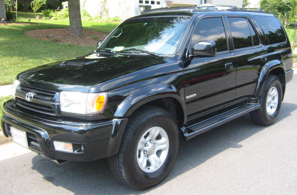

im about to replace my brake pads, rotors, and struts (all only on the front, not touching anything in the rear) on my 2002 sport edition 4runner. my buddy gets a 20% discount on parts at the local toyota dealership. i called toyota today and these are the prices they gave me (before my 20% discount through my friend)
pads - $64.47
rotors - $98 each
struts - $104 each
my question to you guys is this:
would you go with all stock parts straight from toyota as listed above (minus 20% for my connection) or would you go with aftermarket parts?
my buddy suggested going with factory pads and POWERSLOT rotors ( http://www.powerslot.com/pages/power_slot.html ) and Bilstein struts.
i can find the powerslot rotors online for about $100 each, and my buddy told me i can find the Bilstein struts for about $75 each online. I dont know anything about aftermarket car part manufacturer brand names (whats good and whats crap?)
FYI - im installing this stuff myself. also, i do zero offroading, so far my 4runner has been 100% street use. so im not sure if i really need heavy duty bilstein struts, but if they are a great strut, and its about the same price that im paying for the OEM, then why not, i guess... but, i dont want a really stiff ride if thats what its going to give me.
so? what would you do? any suggestions for brand names or part numbers or web links for parts you might choose to use? any advice? im open for anything you wanna throw at me!
thanks in advance!
william
