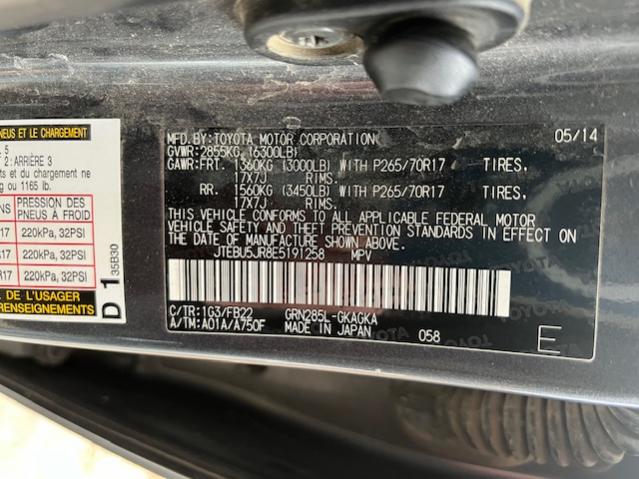

Where do I find the paint code on a 2014 SR5? It's the dark or Magnetic Grey. Need to order paint for a hood and front bumper shell.
It’s on the VIN plate. Bottom left.

VIN plate under the windshield is barely readable in the Northern Light of Montana.
VIN: JTEBU5JR8E5191258
Or the tag in the driver's side door frame:
It's on the door Vin tag, as mentioned bottom left, not the lowest set of digits but the one above it which reads.... "C/TR:1G3/FB22" .... the 1G3 is the paint code.
