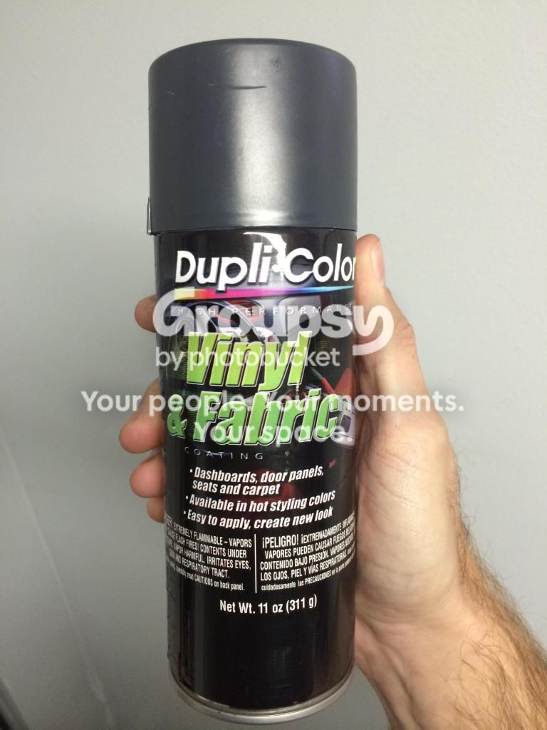

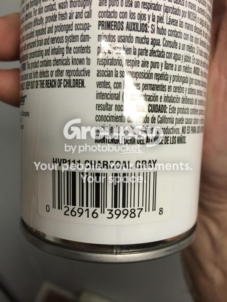

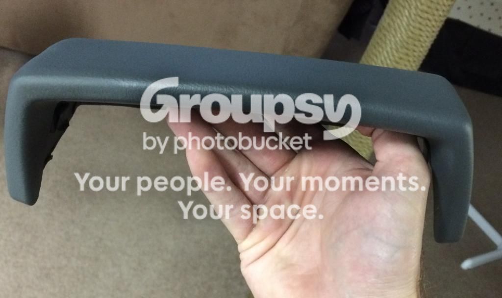

I've used the Duplicolor darker gray interior paint on mine and it matches perfectly. It doesn't quite have the semi-gloss shine like OEM, but nothing a good coat of Mother's or Meguiar's interior rubber, vinyl, plastic cleaner/conditioner won't fix.
Just when you do it, clean it really good, spray a good self-etching primer on first, then a primer sealer, then the interior paint. I found that combination worked very well and hasn't came loose yet.

It will be a perfect match if you have the dark gray interior. The cap definately looks too dark however, but the dye is perfect.
Pics:

Yeah it doesnt matter if its in te sun, shade, flourescent garage lighting - I am hard pressed to see any difference. Its practically an exact match.
Sweet! I think I might have tried the slightly lighter one, I think it's called "dark gray". The cap was a perfect mtach but the color was a light stone color. I'll try that one today.
